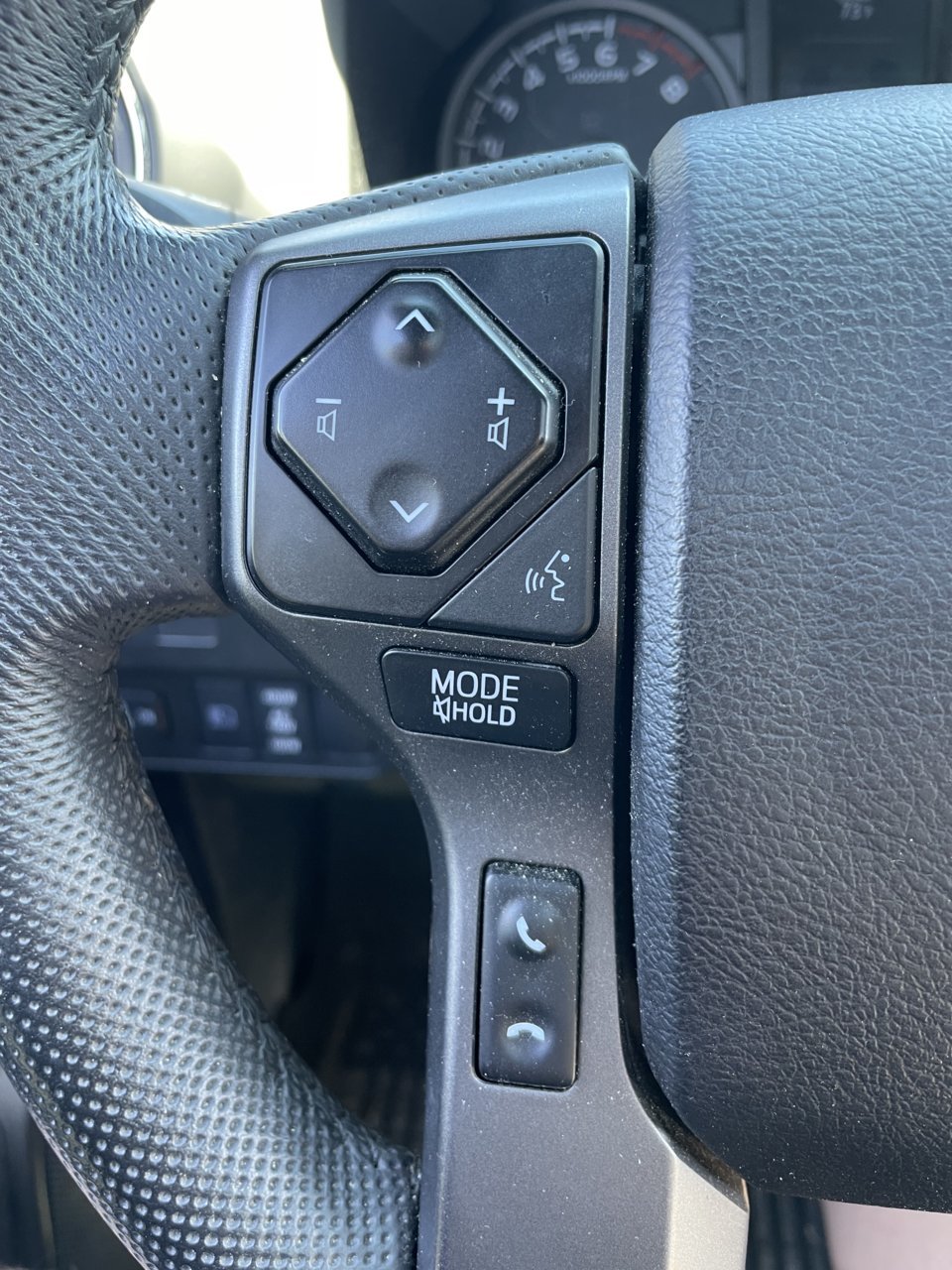

    Happens to me too. I uses to unplug it and plug it back in but I realized I have to go to the audio setting through dash (not radio) using steering controls and unmute audio. No idea why/how it gets muted as I have yet to find a mute button but it’s worked for me doing that.

    I believe there’s a mute button on steering wheel

    so after reading your post I got in my truck to head off to work and audio froze up just after plugging in, so I pressed Mode/ hold button on the steering wheel and it works so for some strange reason it randomly mutes itself! I asked my dealer if they knew anything about it as i had to drop off my truck this morning for a different reason, and no they didn’t know that

    For some reason I was thinking pause/play button on steering wheel. I knew the mute was there but also never used it and never thought about holding that down instead of going into settings and doing it the long way lol. Thank you for this!
