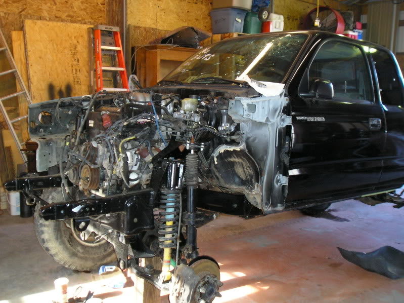

    Ok ~ I'm stumped. I've got a 1999 V-6 4wd TRD
    I drove the truck into shop for auto body repair (Crunched Lft front)
    Disconnected and removed battery.
    Removed all components from driveres side inner fender (Emissions vacuum box / Fuse box and Left side engine room harness). I tied harness up across engine out of the way careful not to pull on it but secured it enoguh to be out of ht way of the saw / welder / inner fender.
    I then cut inner drivers fender off of truck. Replaced / Welded in replacment inner fender. Reinstall all components / vacuum lines / wires / fuse box ect...
    Engine will turn over but no fire to the plugs. Does not try to fire. I do have signal to the EFI relay on the left inner fender fuse box. I do have 12v power to the coils
    I'm guessing it is a harness issue (either from the crash or the repair) and I'm missing power to an ECM circuit some where.
