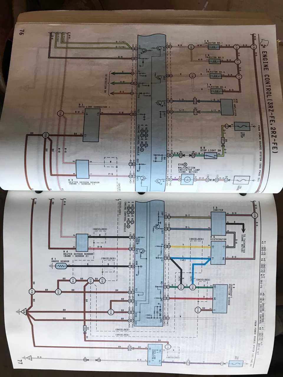

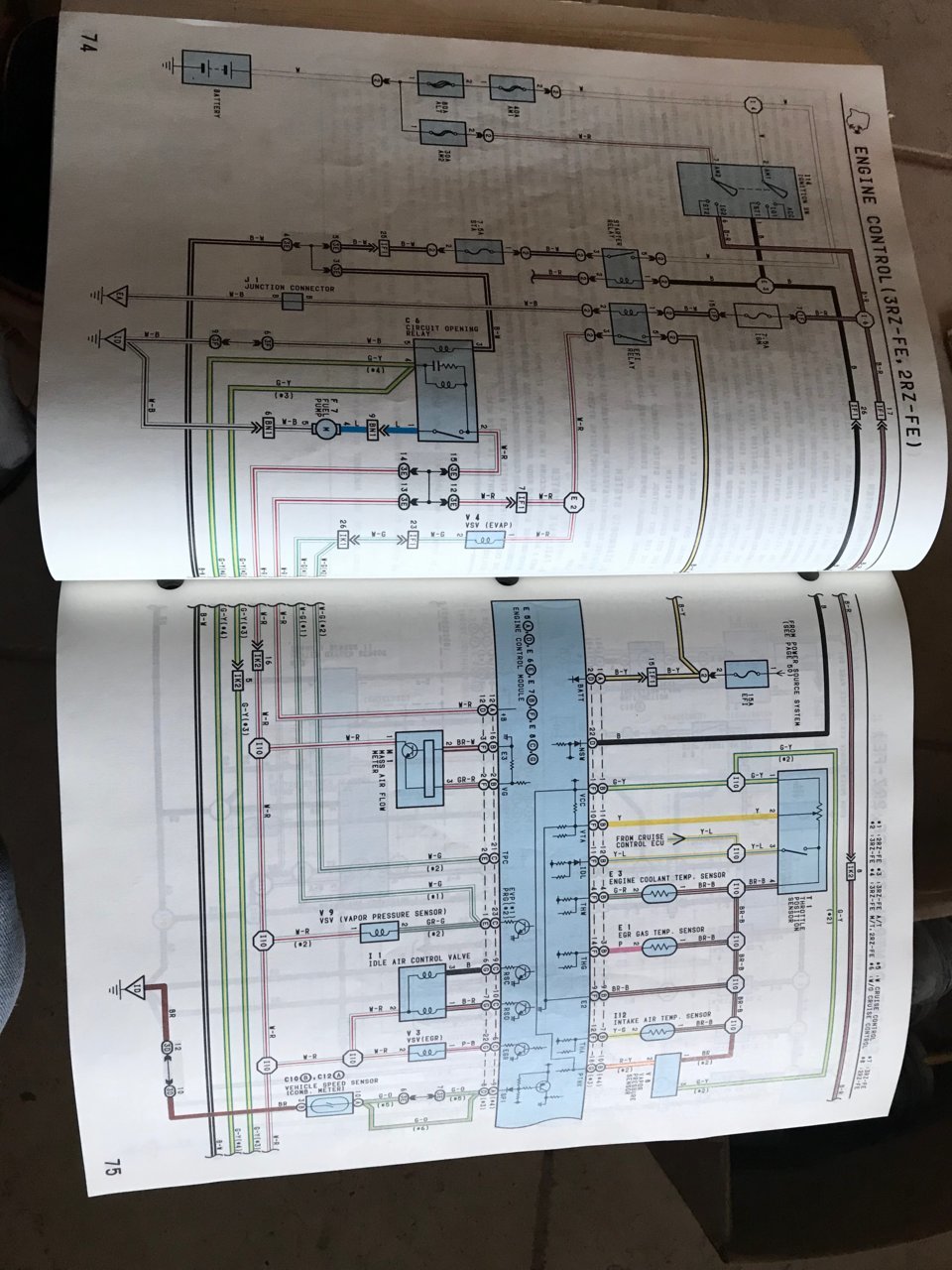

    does the check engine light illuminate during the bulb check portion with the key on?
    hope these are usable.

    OK at least the PCM is powered up. Not trying to be be funny but "new" stands for never ever worked. You could have just received broken parts. It is was me the first thing I would check is - is the distributor shaft turning when you crank the motor. Then with the wiring diagrams provided I would check the relevant fuses and grounds. There are 3 ground points on the 4 cyl model. One is in the left kick panel, one is on the D/S fender and the other is near the throttle body. Give each individual wire a wiggle. it could be broken internally. If your truck has a tach does it wiggle during cranking? This is usually an indicator of if the crank position sensor is OK. There should be a ground off of the back of the head to the firewall too.
