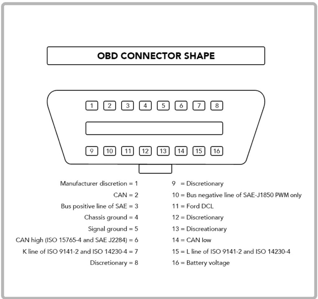

    I'd check the OBD2 connector for Power and ground.
    Key On.
    Check pin 16 to pin 5
    And then check pin 16 to pin 4
    You should show 12v each time.

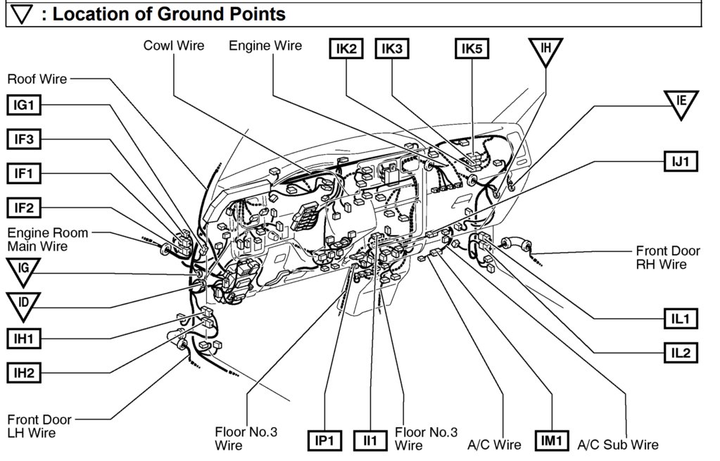

    Well, I know the SRS and OBD2 port share a common ground.
    So all we can do without a meter is check that ground wire.
    Let me see if I can find where it is located.

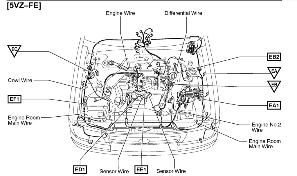

    Check the ground wire where it bolts to the truck at EB.
    Then at IE
