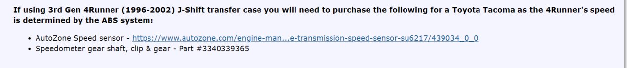

    Anyone have any ideas?? I just checked my speed sensor and it seems good. I spun it by hand and got a reading on the dash. I measured from the mounting surface of sensor to the gear drive and both tc are the same. What am i missing as to why this wont work?
  12. Sep 10, 2022 at 10:39 AM
    mlcc
    mlcc Well-Known Member
    May 2, 2015
    #154429
    1,911
    Oregon
    2002 DC TRD/ 1995 4runner
    Mid travel, armour all around
  13. Sep 12, 2022 at 7:37 AM
    Cvan
    Cvan [OP] Member
    Mar 22, 2021
    #360160
    7
    2004 trd
    Trd supercharger, 4.88, twin locked
    @mlcc awesome thanks for sharing that thread. That fixed it for me too!

    Couldn't find much info on this but swapping the worm gear from my electric shift case over to the new Jshift case fixed my speedometer to. The Jshift case has a worm gear thats to small for the speedo gears to contact
