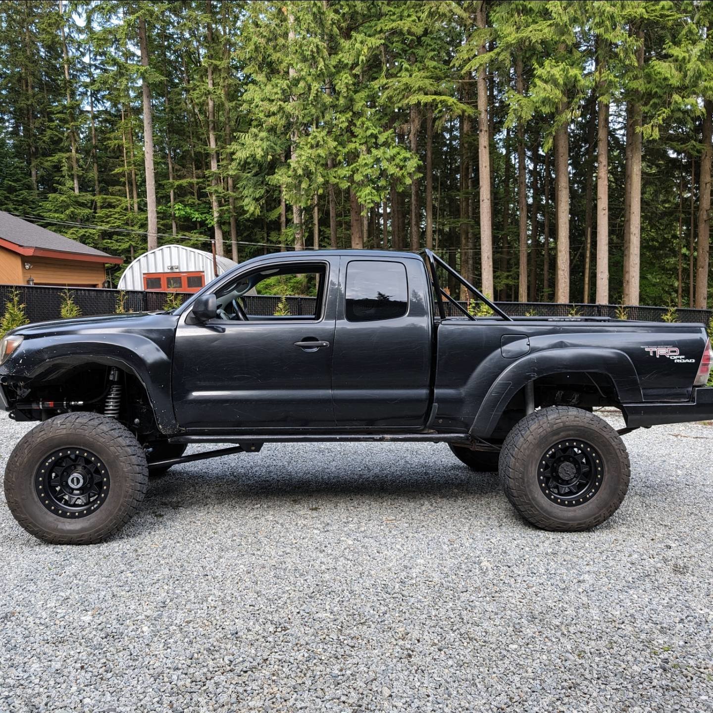

    Hey all,
    Just wrapping up my dana60 and Ford 10.5 axle swap and I no longer have a functional speedometer. I have read that on my automatic truck the vehicle speed is obtained from one of the abs sensors? Has anyone found a way around this to get vehicle speed from somewhere else? Here's my truck so farIMG_20240608_191913_136.jpg

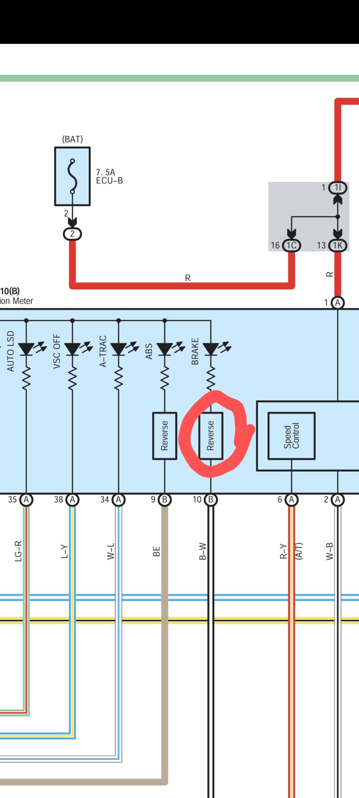

    Does this "reverse" mean reverse polarity? So in this case when the signal goes low, the brake indicator lamp turns on, and when 12v is present, the lamp turns off?
  13. Jun 9, 2024 at 9:43 PM
    Dm93
    Dm93 Test Don't Guess
    Mar 3, 2015
    #150066
    13,262
    Texas
    2014 DC OR 6spd 4x4
    Predator tube steps, Ranch Hand grill guard, Magnaflow CatBack exhaust, Toyota tool box & bed mat, 2LO Module by @Up2NoGood, Rearview Compass/Temp Mirror, Tune by @JustDSM.
    It pretty much means the logic for the indicator light is inverted, normally a module grounds the circuit to turn a indicator/warning light on.
    The ones that have reverse by them the module grounds the circuit to turn the light off.
    This is essentially done so that if the module responsible for turning the light on is offline or disconnected the warning light will still illuminate.

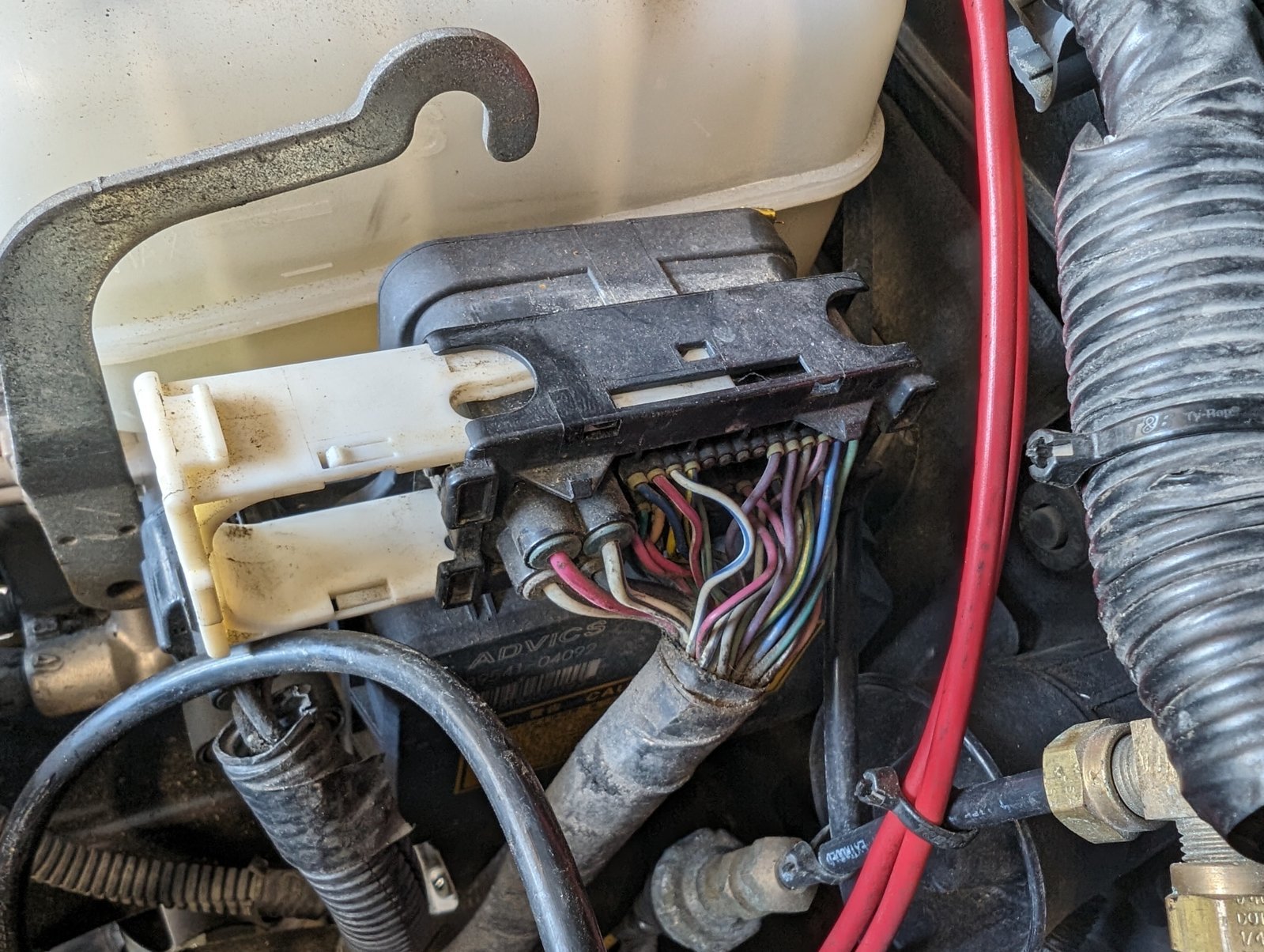

    If your truck has the speed sensor port on the transfer case, I believe you can go that way too.
    Somewhere, on this site, there is a post where a guy made this work. I don’t remember much about it.
    But I crawled under my truck just to see if I had the port. And mine does. It’s rummered later model truck didn’t have it.
    But I don’t know?
    Anyways, I’ll see if I can find the post tomorrow.
    If you buy the speed sensor for the transmission, you can wire to the cluster best I remember?IMG_3924.jpg
