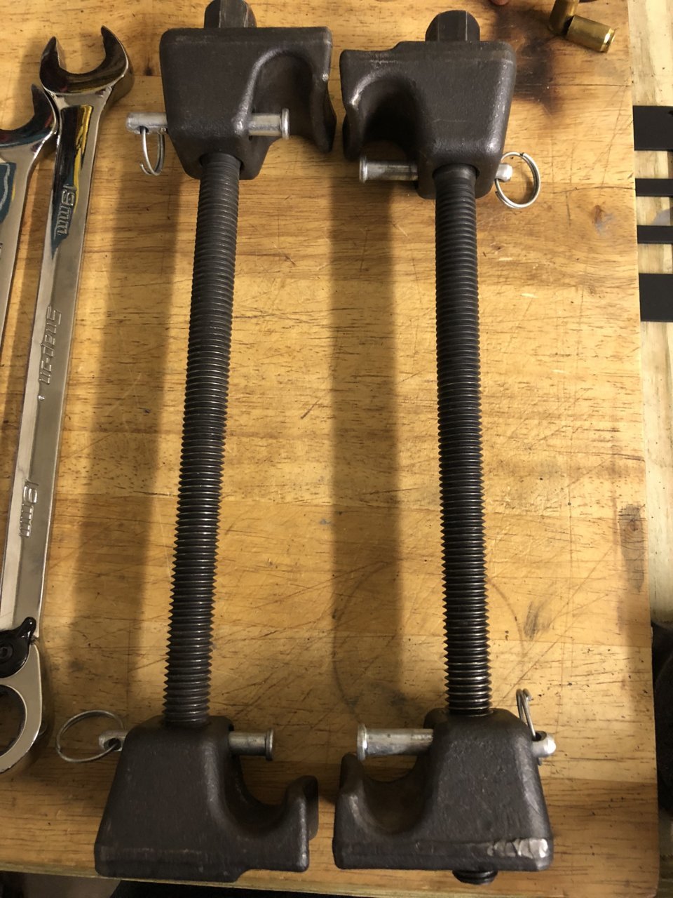

    When installing Bilstein 5100s (retaining original coils) it seems the prevailing DIY method on 2nd gen's is to use the no spring compressor method. Is this doable on our 3rd gen's as well?

    These springs are designed to support the front end, the heaviest end, of a 4300 pound truck.
    If you’re asking here, please don’t mess with the springs. Bring it to a shop and pay them $150 bucks to swap it out for you.

    The answer to your question is yes you can use the truck to compress the spring. It does need to be done carefully and I would not recommend putting the retainer clip above the first setting... if going higher to 3 or 4, best to have a shop do it. I found that I needed to bolt everything together with exception to the top shock nut and washer. Put the wheel back on and lower the truck until the nut and washer could be secured. It's doable, but a pita.

    When I compressed my shock and spring I just used a long pry bar and got lucky enough for it to slip into the notch on the LCA so I could slide a bolt in

    something along the lines of bolt the shock into the lca line it up with the top hat jack up the lca. full disclaimer im not paying for your medical bills

    I appreciate the responses/advice. I think I'll decide at the time but will get the spring compressors and a cat just to be safe. thanks

    Don’t over think it bro....the no spring compressor method works great! Used this method several times even using top clip on the 5100’s. Do one side at a time and support the side you’re working on with a jack stand and back up that with an extra jack....
    I would be more worried about being injured using a portable spring compressor.....and cats for deflectatory measures.:D

    As other said, Spring compressors, that’s what they are designed for and work very well at the job. Like any tool, make sure you use a quality set. Simple, can’t really go wrong, unless you’re lazy or an idiot, in which case you shouldn’t be doing the job yourself in the first place.
