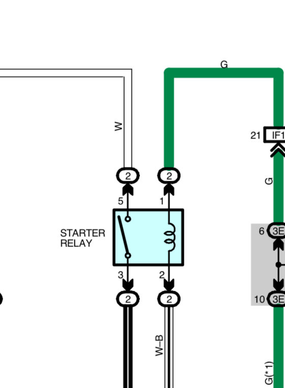

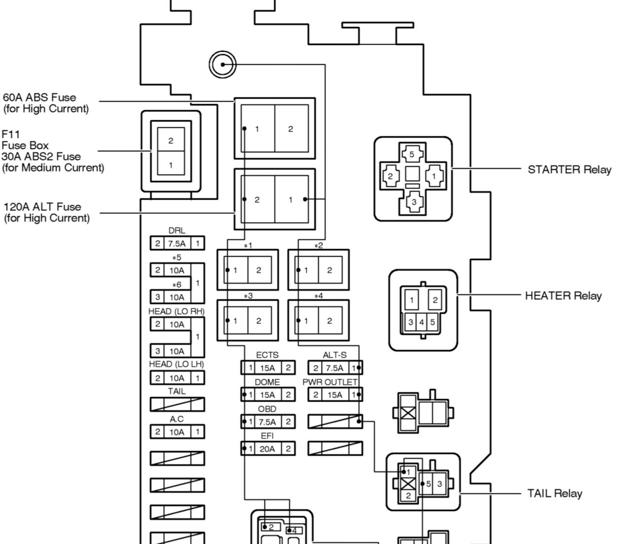

    Pulling the starter relay and testing the terminals will cut diag down by half.
    Pull the relay and check
    Pin 5 for power at all times
    Pin 1 power when cranking
    Pin 2 for a ground
    A3C52C5C-9F77-4F4E-85E9-9CBC52B9D94A.jpg 25A99322-E895-4D69-B408-BCB748D014FD.jpg

    TnShooter
    TnShooter The TacomaWorld Stray
    Sep 2, 2010
    #42625
    21,361
    Deogee
    07' TRD Off-Road, Auto
    STOCK
    If all the above are good, we can move on to the starter control and power wires.

    I’ll have to jump into that tomorrow evening, it’s in my shop at work. If the relay checks out then checking the control wire while turning the ignition for power would be the next step correct? Essentially that triggers a relay in the starter completing a circuit?
    TnShooter[QUOTED] likes this.
  14. Oct 4, 2022 at 6:21 PM
    TnShooter
    Sep 2, 2010
    #42625
    21,361
    Deogee
    STOCK
    Correct:thumbsup:
    You sound like you know what you’re doing.
    You’ll have it fixed in no time.
    If the control wire is good.
    I’d then do a voltage drop test on the big wire from the battery.
