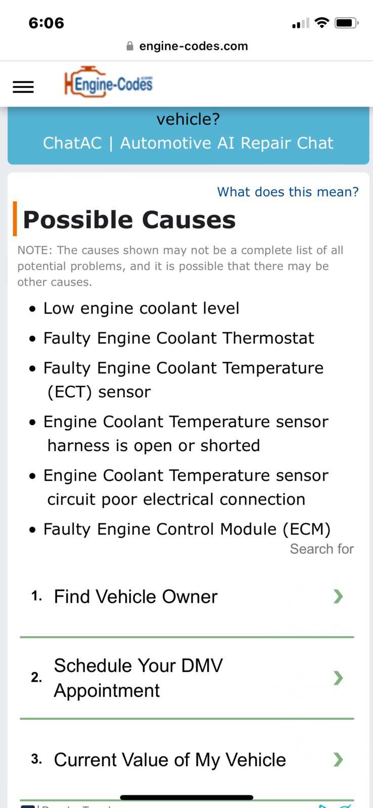

    Unplugged the ECT pigtail
    Kinda started (with finagling)
    Popped P0115 again

    Reckon that p0145 is from where you checked rail pressure? That ECT p0115 gunked up from the flush moving stuff?
