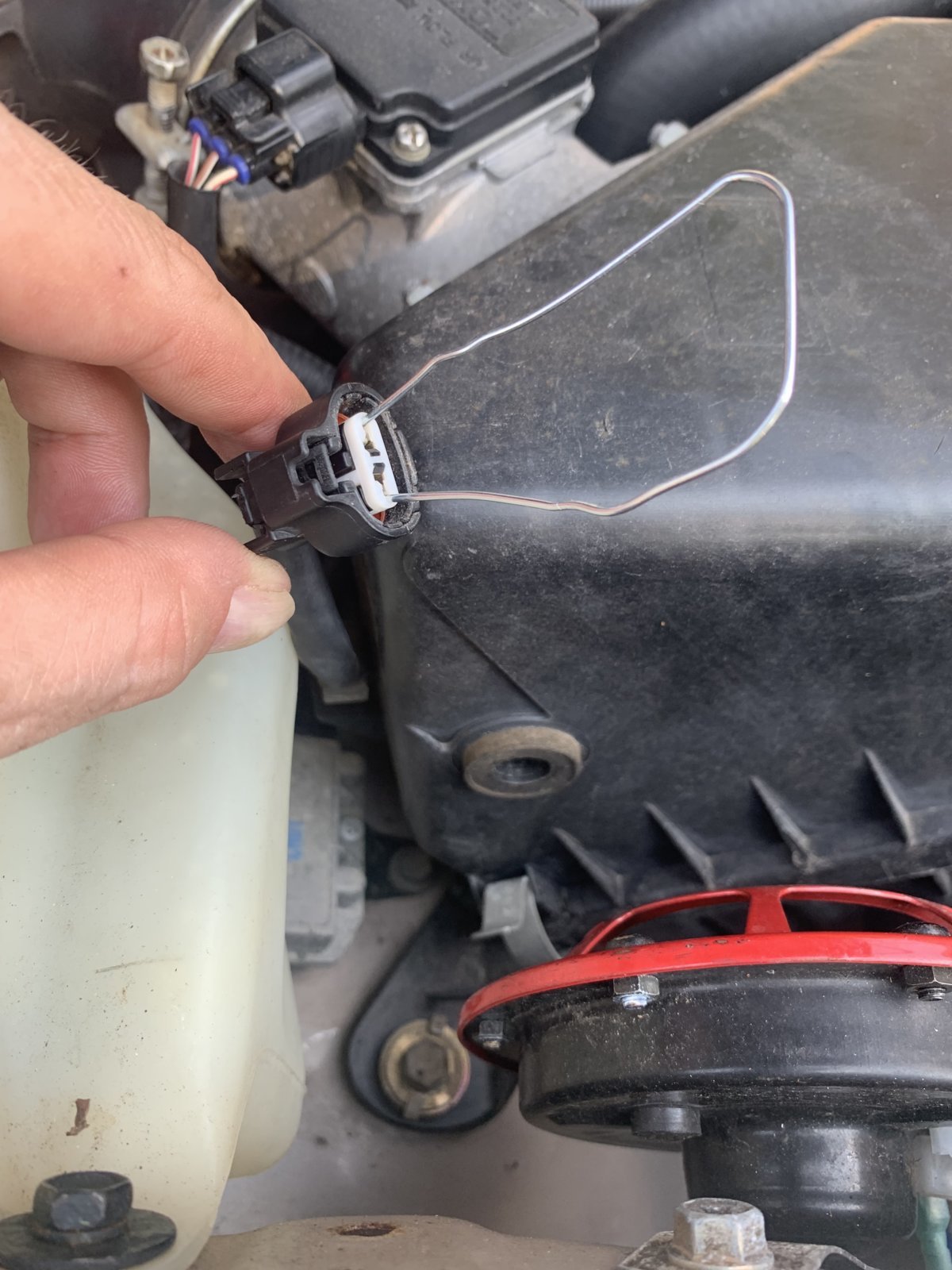

    Holy Shit
    no continuity for that airbox sensor
    just for testing, paper clip trick to bypass?

    I think that'll go to like 250*F so maybe don't cause I'd bet it'll start like shit still, its a common sensor on old toyotas though, I have a couple from my old corolla, bet the local auto parts store has one for ya

    Despite no continuity
    Ohms moved down when I put a lighter to sensor….moved down
    Put sensor in front of a fan moved up
  10. Aug 6, 2024 at 3:01 PM
    #30
    ControlCar
    ControlCar [OP] My Moto: Help & Learn…period.
    Jul 22, 2023
    #429578
    3,376
    Steven
    Sugar Land TX
    1996 Taco 2.4L 2wd Automatic
    Clock Volt meter/LSPV Delete/Hyundai 16’s/FP gauge/after 9months of wrenching ZERO oil leaks
    Paper clip method?
    not to Loadie fix
    But to test if she starts?

    as far as readings all over the place
    But once I firmly applied contacts, definitely went up and down

    WOW
    Started right up
    Popped P0110 air temp circuit
    (Obviously)
    incredible!!!!!!
