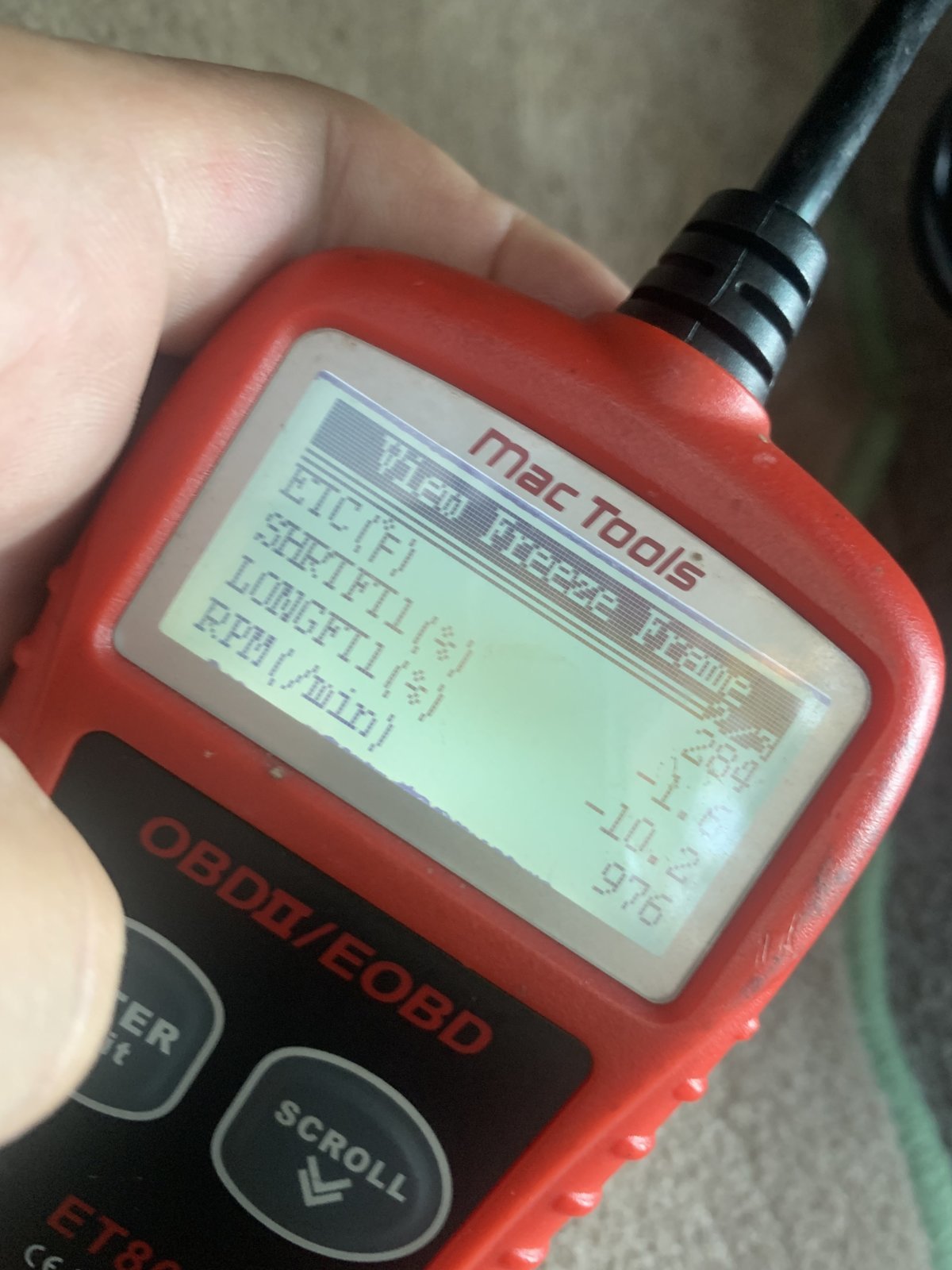

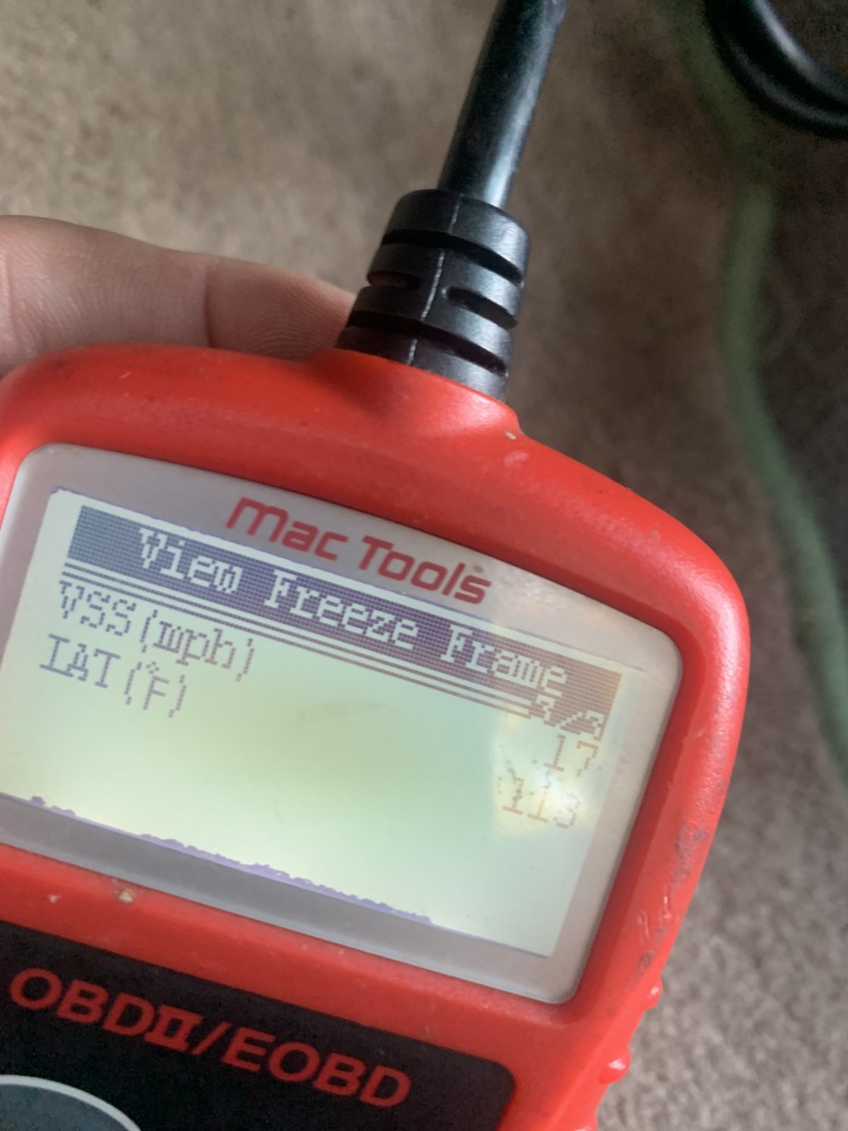

  4. Aug 12, 2024 at 5:41 PM
    #44
    ControlCar
    ControlCar [OP] My Moto: Help & Learn…period.
    Jul 22, 2023
    #429578
    3,376
    Steven
    Sugar Land TX
    1996 Taco 2.4L 2wd Automatic
    Clock Volt meter/LSPV Delete/Hyundai 16’s/FP gauge/after 9months of wrenching ZERO oil leaks
    Coolant temperature shows 284?
    Intake temp 113?
    like DM93/speedytech stated, points to ECT sensor
    But she doesn’t start when ECT pigtail unplugged?
    im going to try unplugging ECT sensor again….
    When she cools down
  5. Aug 12, 2024 at 6:27 PM
    #45
    Speedytech7
    Feb 20, 2014
    #123587
    57,962
    FCQM+VG Cheney, Washington
    It's less Tacoma and more mod
    Yeah that coolant temperature sensor is toast. That's a fully maxed out reading it's open circuit

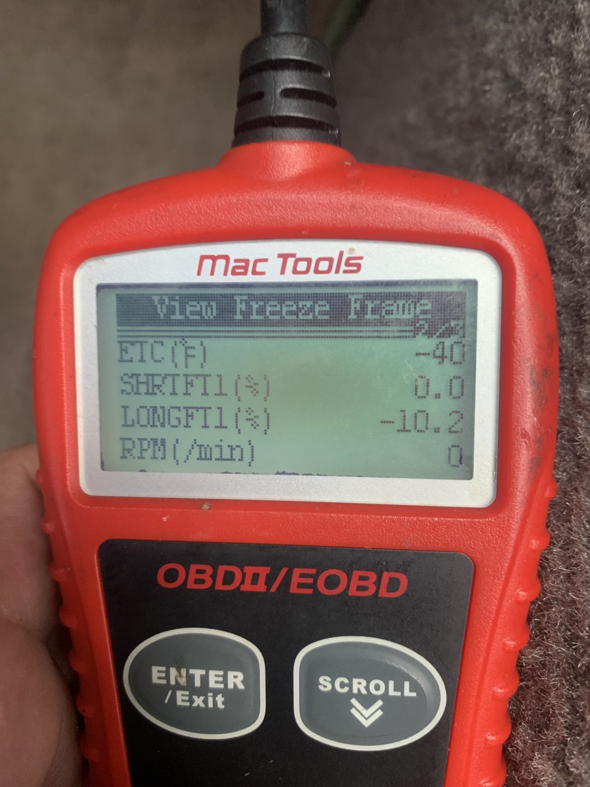

  6. Aug 12, 2024 at 6:29 PM
    #46
    Dm93
    Dm93 Test Don't Guess
    Mar 3, 2015
    #150066
    13,501
    Texas
    2014 DC OR 6spd 4x4
    Predator tube steps, Ranch Hand grill guard, Magnaflow CatBack exhaust, Toyota tool box & bed mat, 2LO Module by @Up2NoGood, Rearview Compass/Temp Mirror, Tune by @JustDSM.
    That's why I wanted to see live data, unplug the sensor and see if it goes to -40.
    If it does we have a sensor problem, if it doesn't then we have a wiring or PCM problem.

  9. Aug 13, 2024 at 4:14 PM
    #49
    ControlCar
    Jul 22, 2023
    #429578
    3,376
    Steven
    Sugar Land TX
    -unplugged ECT pigtail
    -tried to start….nothing….V’s are at 12.0
    B4 I ran down battery
    -plugged in reader…..
  10. Aug 13, 2024 at 5:04 PM
