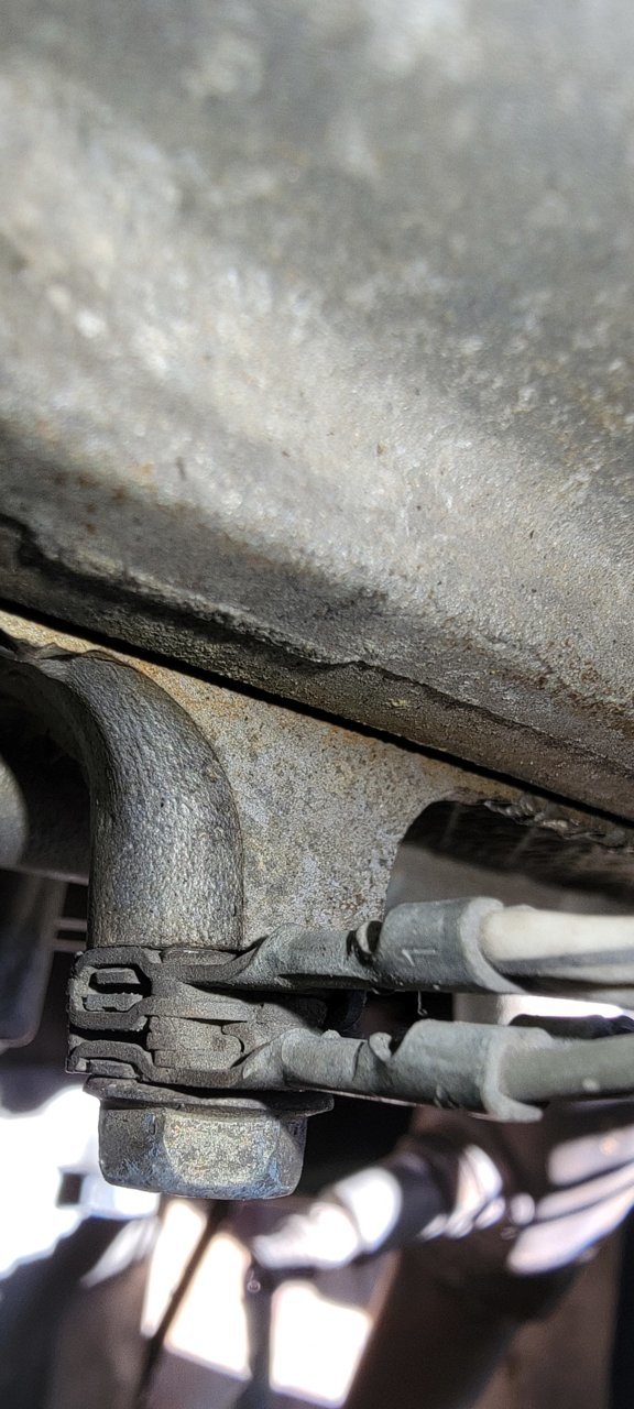

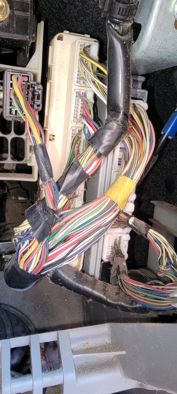

    It was done by somebody else. I'm trying to figure out if I'm getting ground to ecm and there's a boat load of wires trying to trace them down now

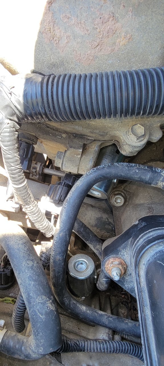

    There shouldn't be a boatload of anything...it should look like nothing ever happened. Post some pictures of anything that looks non-factory so we can have some idea of WTF happened.

    OK thank you. It's all factory but when we pull her the harness got caught on motor don't know if I broke a wire
