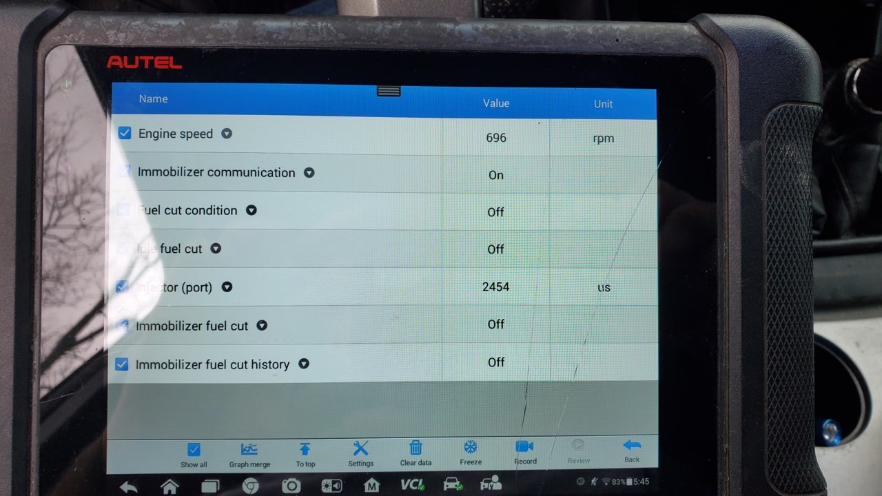

    This is what I see

    Look through your data list for any PIDs related to fuel.
    I'll take a look at mine later and see if I see any PIDs to look closer at.

    Scroll around in engine data and find the Crank sensor (CKP) and cam sensor (CMP) and fuck with it and see if you can come up with a graph showing all 3, then crank it and see if the ECM is seeing data from all 3

    This brings up a question?
    Are the fuel and spark controlled by different sensors.
    Spark is likely controlled by Crank sensor. (And you have spark)
    Fuel might be controlled by cam sensor. As fuel and valve timing go together.
    @Dm93 might know what sensors controls what?
    I know you say you have changed sensors.
    Sure would be nice to have a scope.

    We should see codes for cam and/or crank sensor/timing problems but yea it would be nice to see what the signals look like.
    I know it will run without the cam signals, it will not run without a crank signal.

    You may want to look at these PIDs key on and while cranking.
