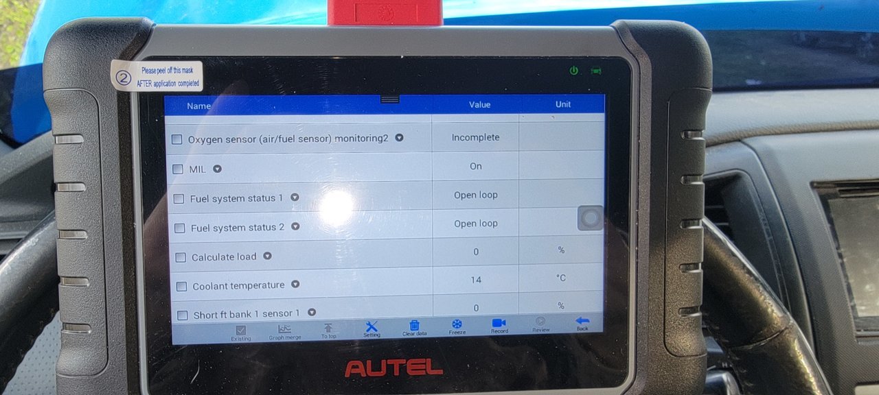

    I just did an update on my 808 I'm trying to figure out how you got there my graph is grayed out so I can't use the graph feature for some reason

    Diagnostics>Toyota>Automatically Search.
    Once you have I'd the vehicle: Diagnosis>Control Unit>Engine&ECT>Live Data.

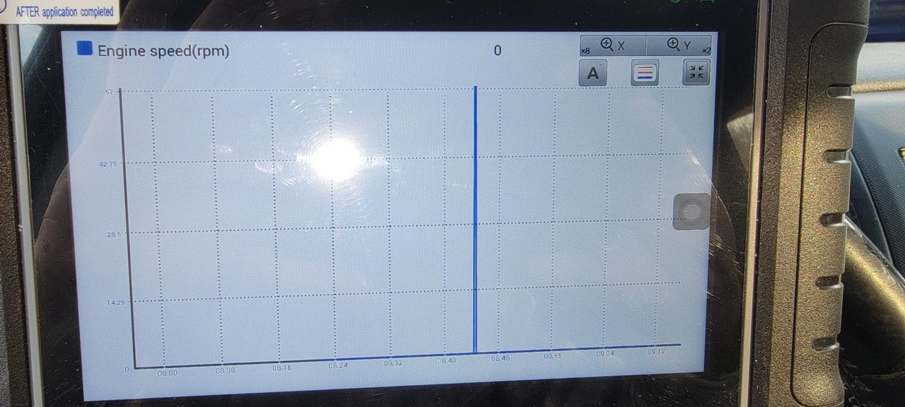

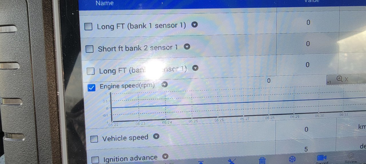

    See how it's not allowing me to graph
    HondaGM likes this.

    I goto remember and it's a flat line

    Sorry rpm

    You have to click the down arrow next to the PID you want to graph and select the graph icon, to zoom in and out on the graph hit the X and Y buttons next to the graph.
    You can overlay up to 3 PIDs on 1 graph by selecting the checkboxes next to them and then selecting graph merge.

    Rpm

    So it stays at 0 even while cranking?

    This is what it shows

    Is this while cranking?

    Yes a spike when cranking

    Looks like the PCM is not seeing a crank position signal or is seeing a signal but not a valid one.
    Hard to belive it's not setting any codes.
    You said a wiring harness got pulled when you were pulling the engine, you may want to look in that area for broken wires.

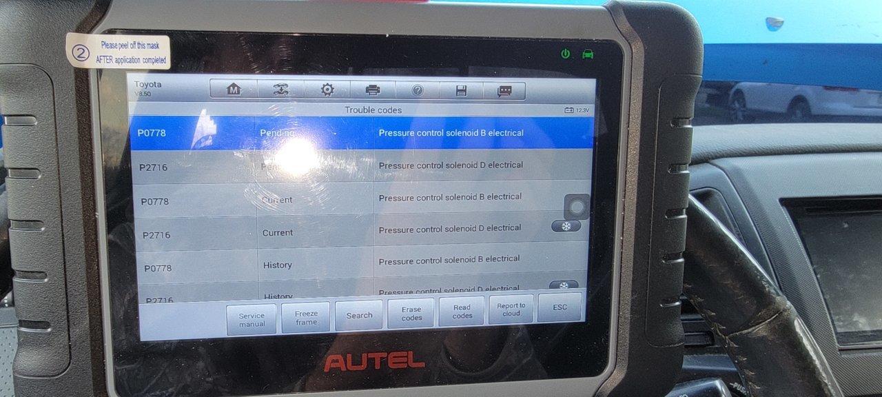

    Ok these are the only codes

    The crank sensor wires are white and black and have a shield wire wrapped around them, I'd look for those where the harness was damaged and see if they are damaged.

    It looks like we don't have a crank sensor signal as we don't have consistent RPM while cranking and OP said some wires got pulled when the engine was removed so why not start looking there since we don't have a scope to see what crank signal looks like?
