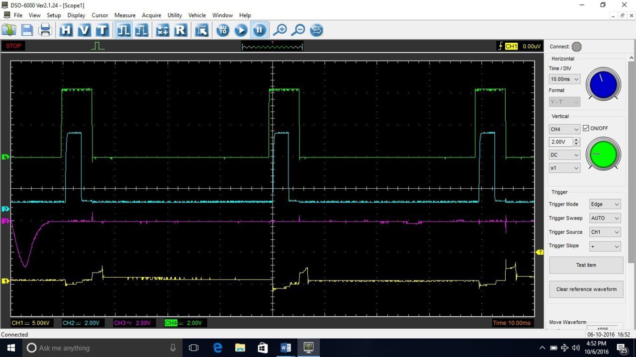

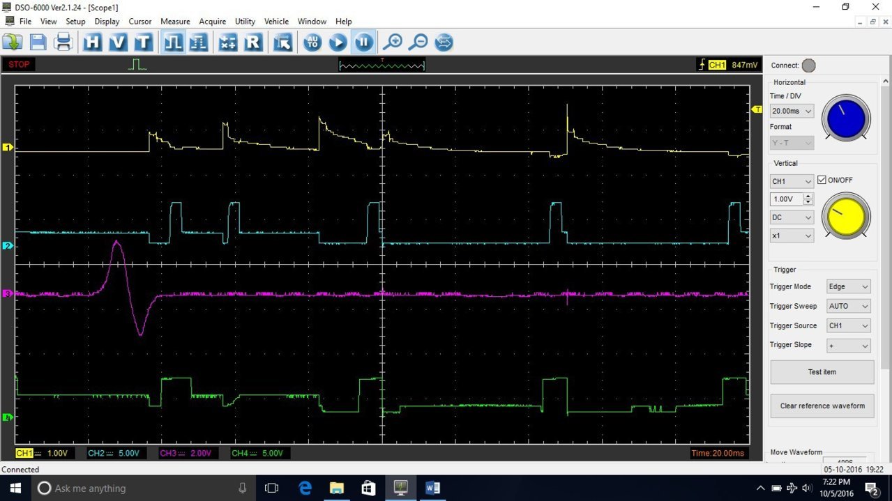

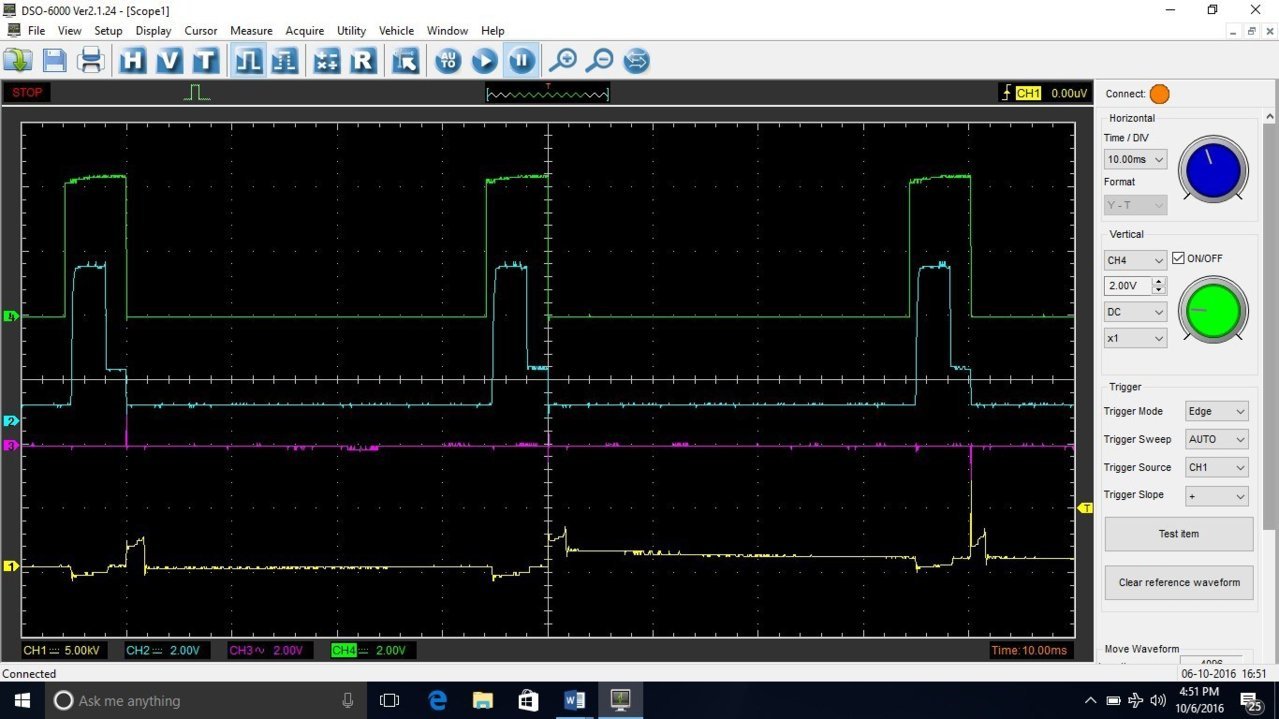

    I had a strange one but on a '96 camry...turned out to be a bad coil driver in the ECM and the ground started coming up on the IGt...very intermittent problem, would run fine and then wouldn't, and wouldn't start at all, then would start and run fine. Finally caught it in the act. Need a scope for this stuff... Had a bad ECM and ICM....not sure which took out the other, but I got it fixed
    check out the base line (ground) on the blue and green trace...blue is IGf, Green is IGt
    Replaced coil driver in the ECM, still have a lifting ground on the IGf
    Replaced ICM, all better
