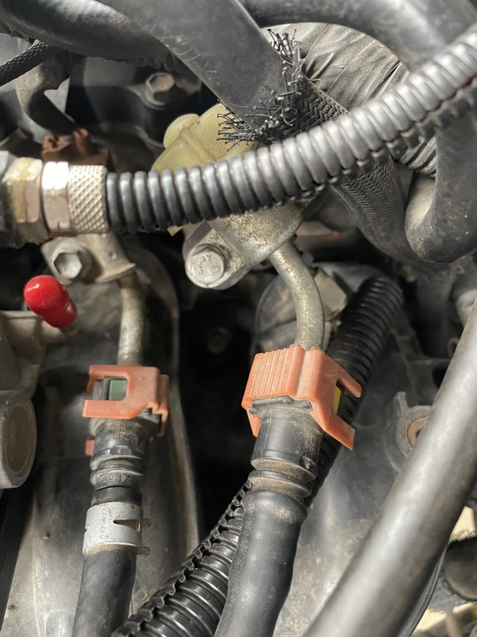

    Fuel lines hooked up correctly? It seems like someone one time somehow got the supply and return hoses swapped on a 2.7 resulting in a no start.
    TnShooter and BassAckwards like this.

    This a solid point. I’ve hooked mine up backwards on more than one occasion and it won’t run. Very easy to mix up on the 2TR bc the lines are the same length roughly

    Here’s how mine are routed for reference.
    TnShooter likes this.

    Fuel lines are hooked up correctly same with all the other lines in that area

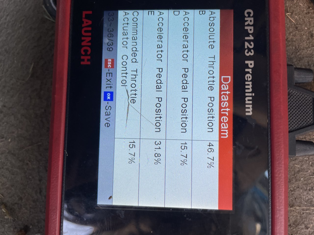

    5F5019A1-3E9B-440E-984F-0E050BB4B2E2.jpg This is my % after resetting the position sensor and unplugging the throttle peddle

    I wouldn't be concerned about that for a no start.
    Do you see RPM on your scanner while cranking?
    Will it run for a bit if you spray some carb cleaner in the intake?
