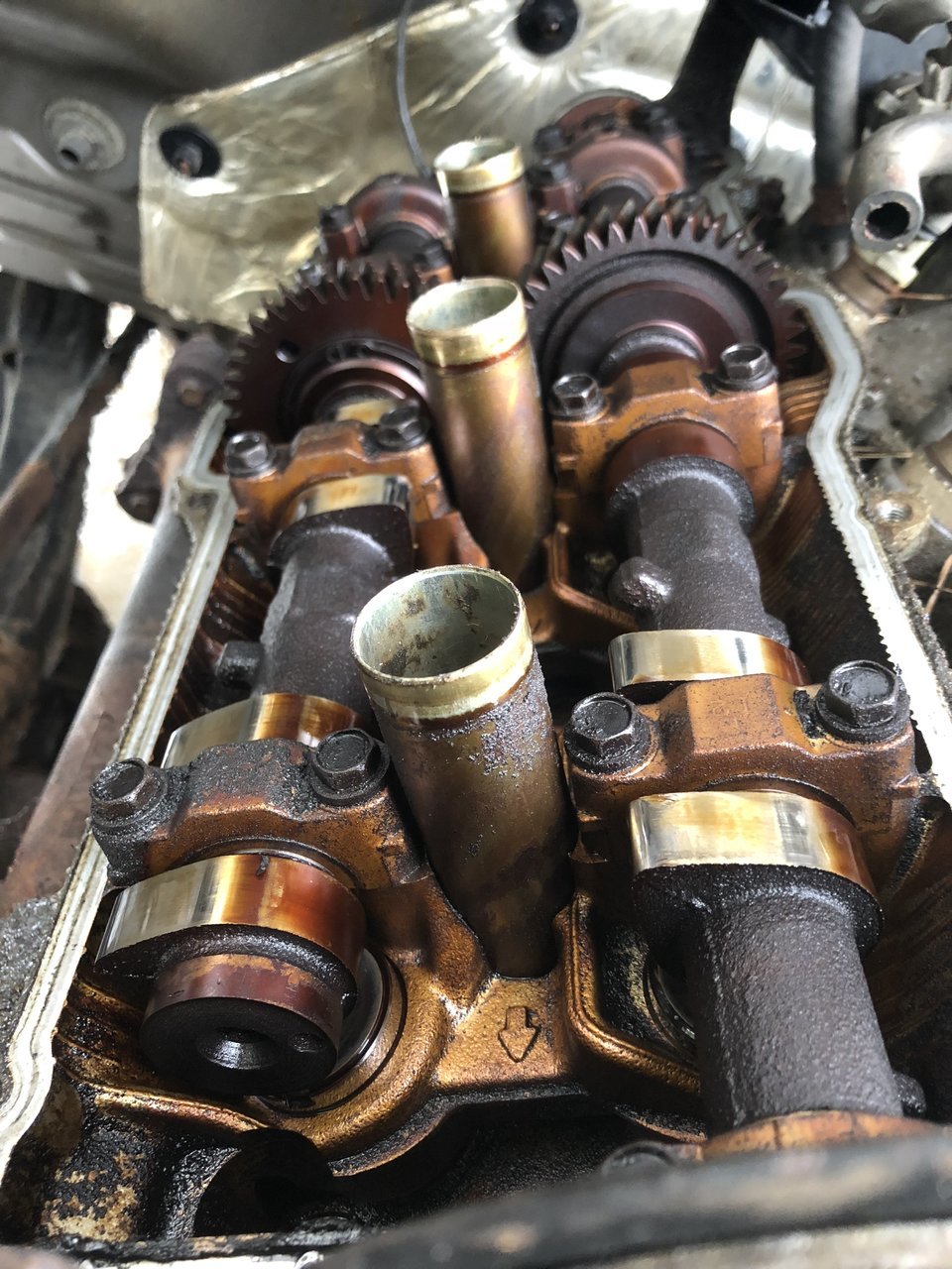

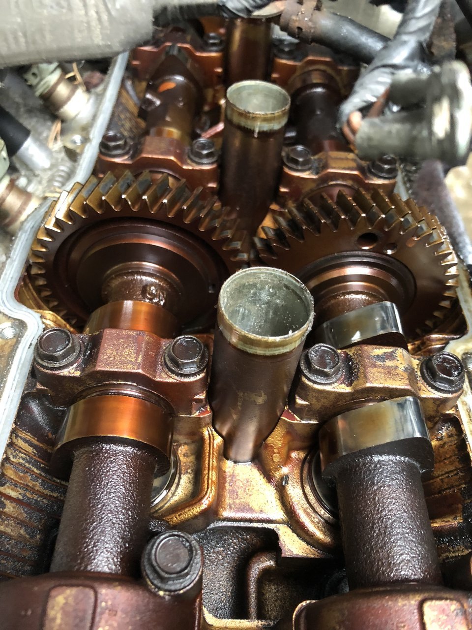

    Does anyone have a picture or diagram of lobe orientation set where it needs to be so I can rule out being 180 degrees out?
    Cylinders 1 and 2 need to be up and closed correct?

    I don’t plan on dissembling it because that’s way more than I feel comfortable with. It ran great for the longest time.
    If a belt got old and jumped... would both cams jump in sync or would just one be out of whack? I hate even coming back to this but it’s what I seriously think is wrong... I should have just replaced the ignition components first before I just assumed the timing jumped and as if that fixed it...
    The reason I keep coming back to this and ask if they would jump and be in sync is because they were both completely in sync with the marks at roughly 45 degrees to the right, with a red splot of paint on the left and black on the other lining up with marks above the cams. I can’t help but to assume if it truly jumped timing and I didn’t just jump the gun that the cam marks wouldn’t both be off perfectly in sync?
