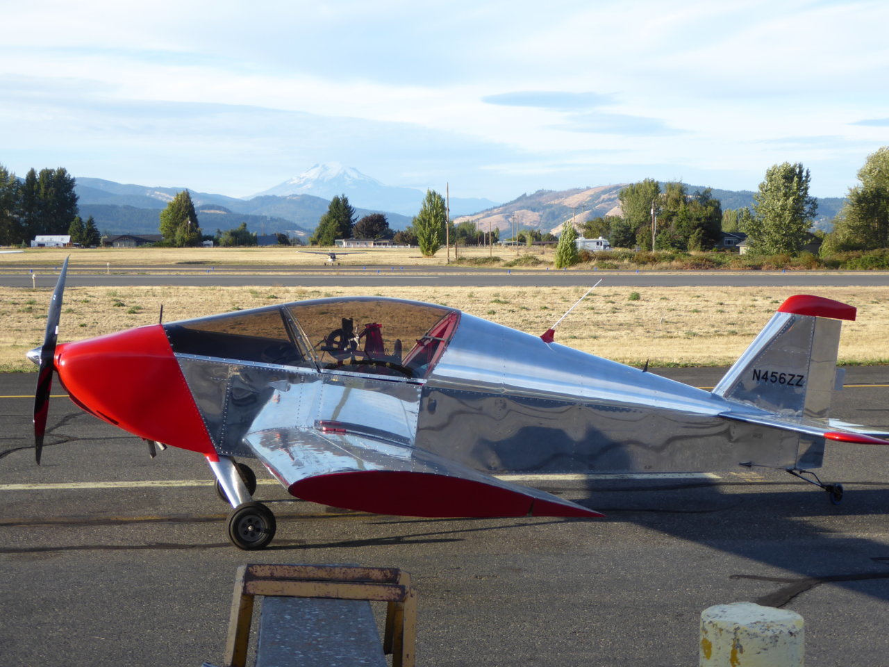

    Yeah, good point. I´m gonna be under there anyway today to remove it so I can try that. Will be an Easter egg hunt to find my tools between where I´ve moved and my hangar 50 miles away. Half here, half there...sorta like my mind, come to think of it. Below is the airplane I built from plans several years ago.

    NICE. I can't imagine the patience required for a project like that.

    You need zero to start but will learn plenty along the way. Took six years, didn't keep track of the hours, but prolly 15-20/wk.
