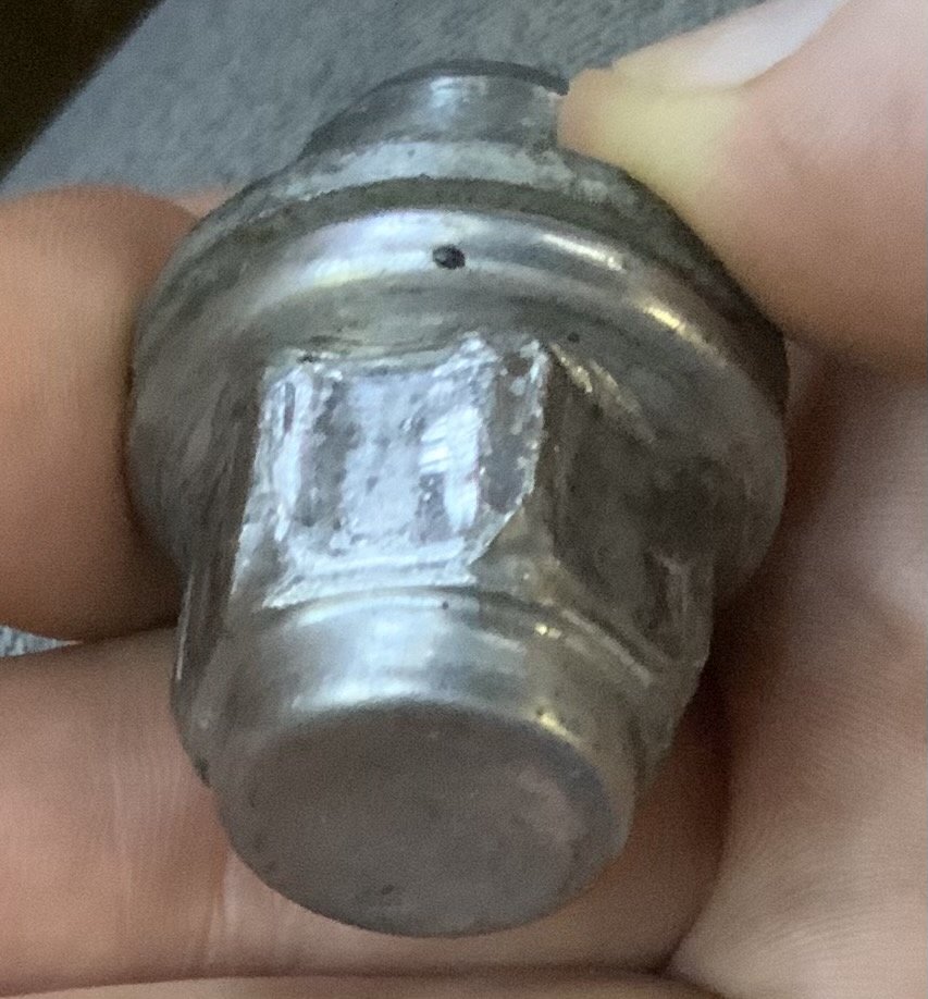

    I started tackling the replacement project yesterday. Took an hour to remove the lug nuts. 2 were 21mm, easy. But the socket didn't fit over any of the other ones. I tried metric and SAE. The ones too large started to strip. Didn't have much to loose so hammered the 21mm onto the rest. IMG_8739.jpg

    I've read that the OEM lugnuts have a stamped cap on them, and over time that can swell causing standard sockets and metric to not fit! No fix as far as I know other than to buy new lugnuts or change to aftermarket that doesn't have that design. Sorry to hear about the starter, it's a pain to get to those bolts for sure!

    Yeah, my lugs did the same thing.
    I ended up buying a special socket just for them. It is a 21.5mm.
    I got tired of beating the lugs out of the 21mm.
