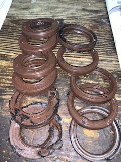

    Sorry man
    I feel you
    I think/guess(from experience with my fuckups)to re check work on T belt
    Make sure at TDC
    all T dots/slots perfect on all pulleys
    Tensioner good
    took me 5 freakin times to align everything
    (This on DOHC Subaru so 5 pulleys 9 separate marks/dots )
    Then cam seals leaked
    All work had to be re-done + seals
    Needless to say
    1st time I did….3 nights
    After the 7th T belt re-do……I can complete in 3hrs(not counting coolant drain/fill/burb)
    double/triple check work
    Your symptoms are similar to timing being off a tooth or so IMO

    That is the 1st 3 times^^^
    Still pissed about spending $200 on oe seals
    That was 3yrs ago
    Still have nightmares
