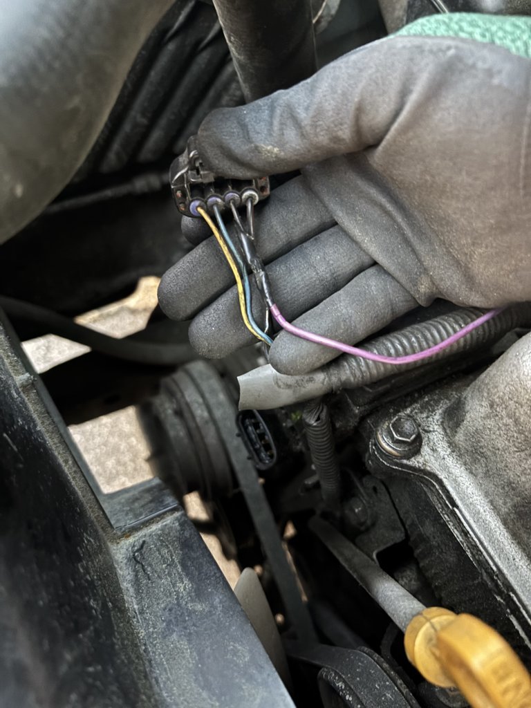

    thanks for the reply. I have found the alarm box. It is crudely wired in under the dash near the steering column and does look like it goes to a bank of 4-5 relays which is what clicks occasionally. There is a single black wire that I traced into the engine bay which goes to where I think maybe the distributor is? I will disconnect it and give it a shot.

    I haven’t removed anything. I did trace this single black wire from the viper module to the distributor plug. It is the purple wire that is spliced into one of the plug wires.

    Wow, some wiley installer put in an ignition cut. A risky move. I'm glad you found it, good work!
