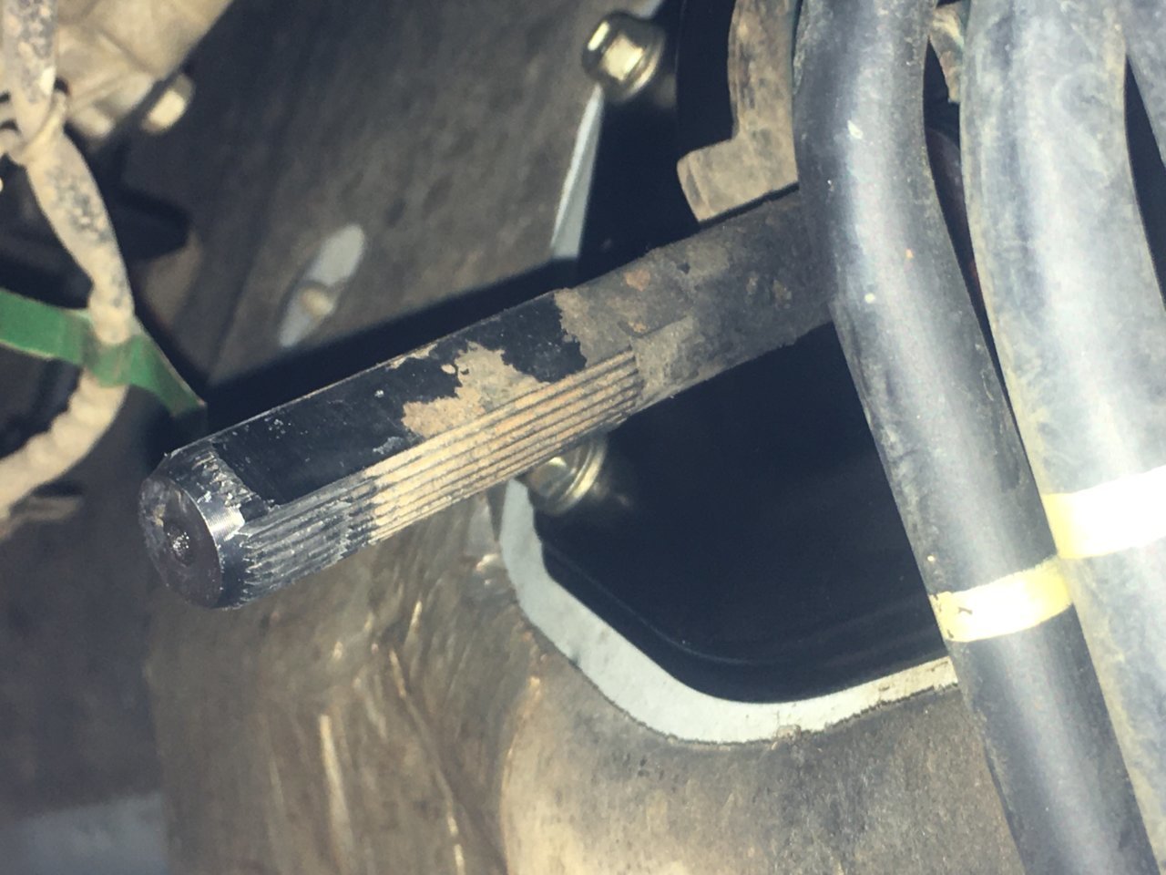

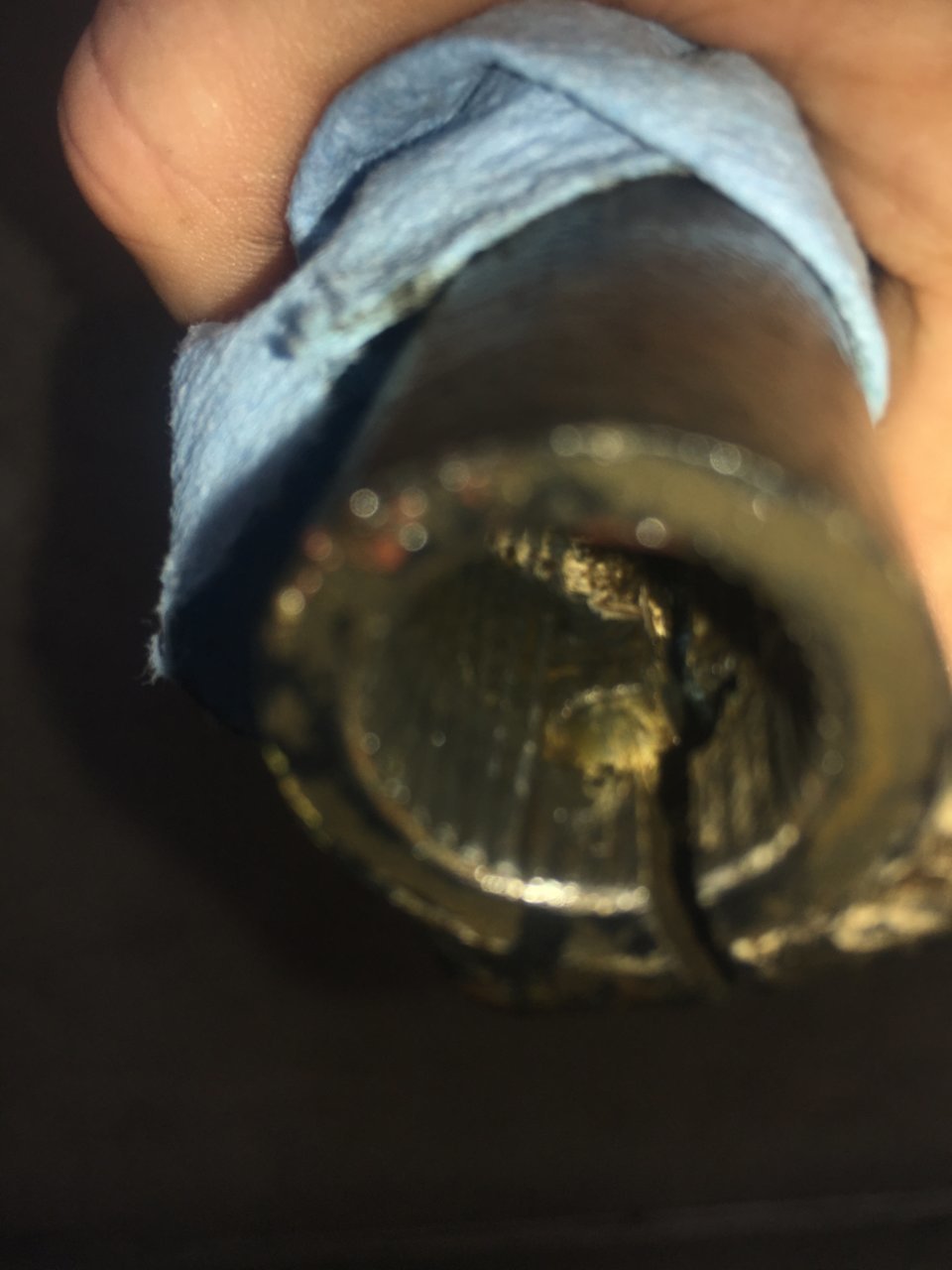

    So to clarify, when installing a body lift, it is recommended to loosen the top bolt on the lower steering column. As there is plenty length of teeth.
    I just removed the lower steering shaft and I’d have to say it looks like the reason the lowest end came off, is because the threads on the swivel joint were indeed trashed. No reason for it really. That end was never modified. sorry about the pic, best I could do.
    The upper end teeth looked brand new. So I ordered a new one and will install that soon.
    Thanks for all yur help guys!

    On my 1st Gen. There was literally a notch machined into the shaft that slides in the piece you are holding. The bolt both acted as lock pin and a clamp.
    My body lift came with a steering shaft extension.
    I’ll admit that I have not worked on the 2nd Gen steering shaft yet. But the design has been around a long time.
    Not sure why they would change to a different design.

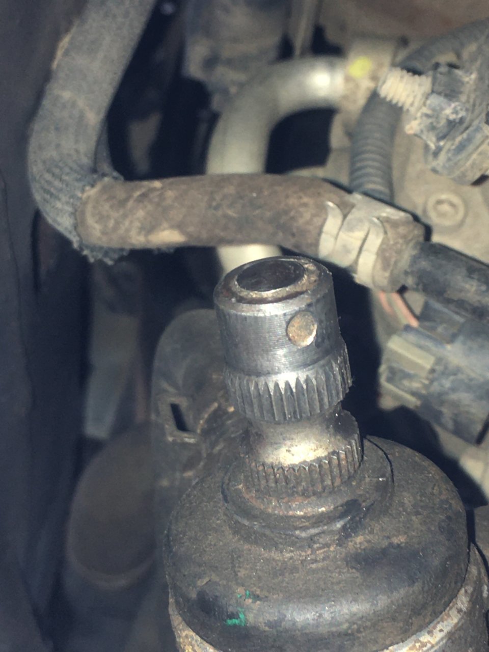

    So the lower male spindle (first picture) on the steering box has a hole which looks like a cotter pin or something goes through it, but there was nothing in it but gunk and there is no hole on the steering shaft for it. I’m assuming/hoping that was meant as a universal design for some reason not applied to the taco.
    The upper spindle (Second picture) has a notched side on it that I’m assuming is to help “pinch” the female spindle onto it.

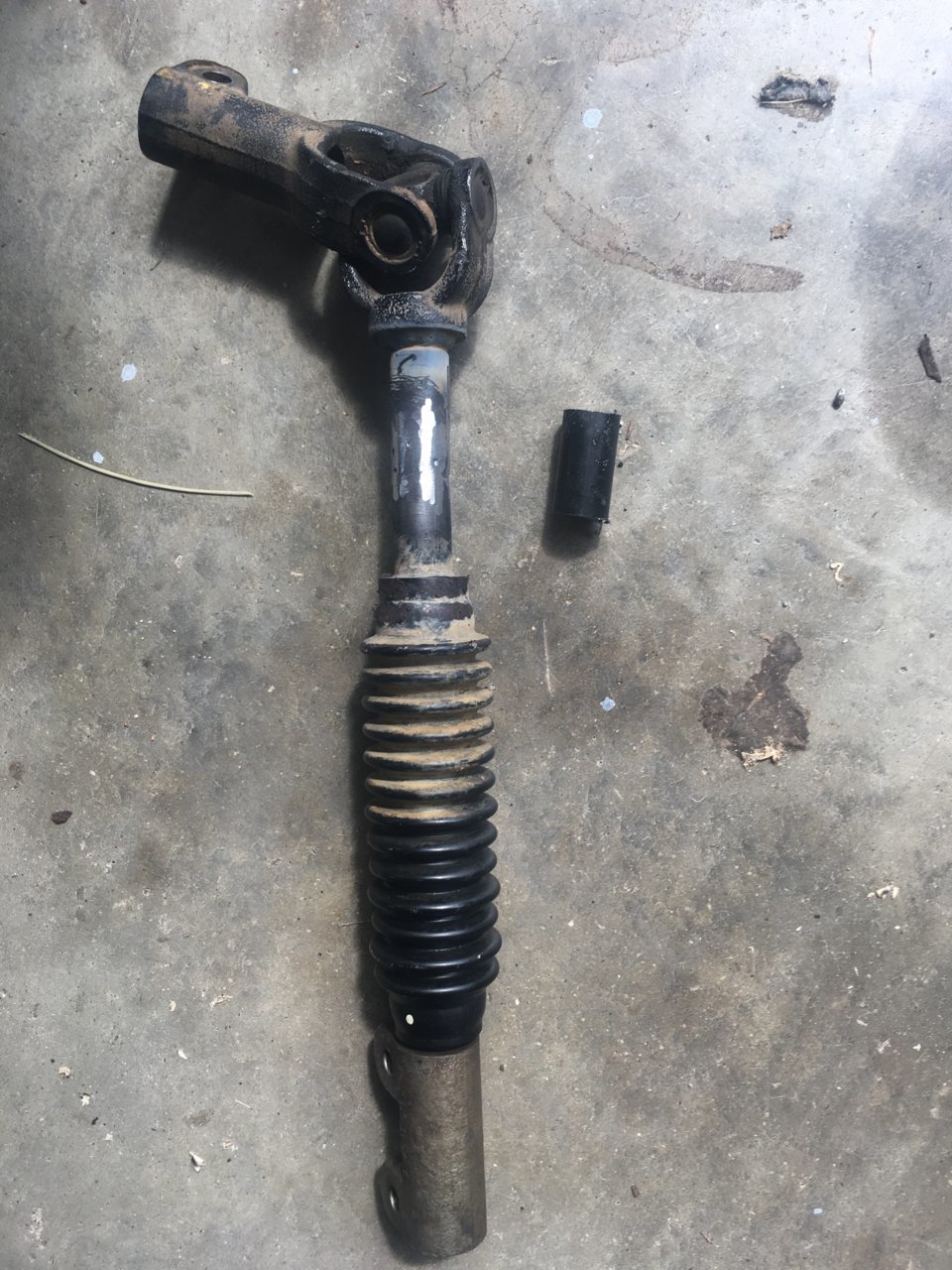

    Just for giggles I did a test run on my old steering shaft. It is solid steel without a center core of different material.
    After cutting the price out that I needed for lengthening the new shaft, I tapered both Edges and welded them together.
    Making the two rods straight was the biggest challenge.
    I banged the heck out of it for about five minutes With my sledge and I think I may have dented it a tiny bit, but it’s solid as...steel! :)
    I’m not sure I’m going to follow through and lengthen the new one. It was a pain to get this weld straight. I’d have to do it for two welds at the same time.
