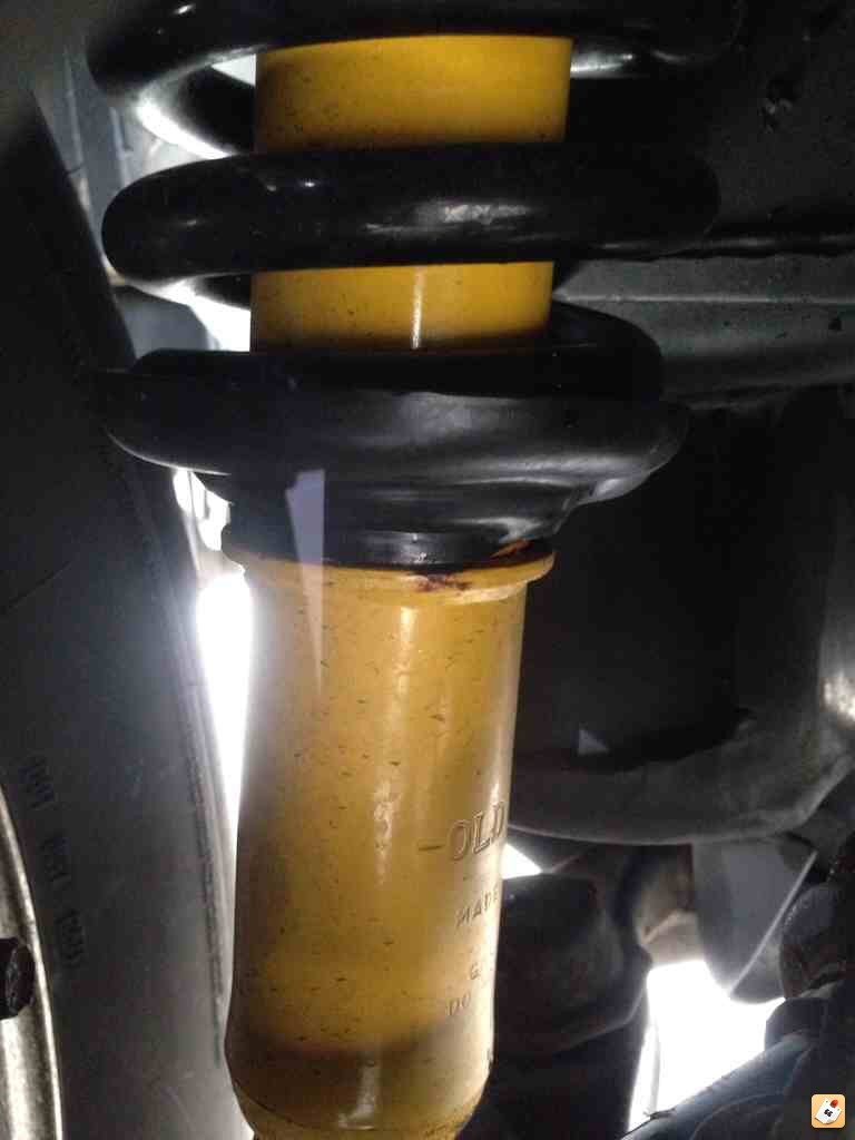

    Is it possible to have no taco lean at all? I've measured my truck when it was full of gas, and damn near empty. From front center hub to fender was 22 1/2" on both sides exactly. It does have the OME lift with 880 springs. There is not a 5mm trim packer (picture shown) on the driver's side or the passenger side (duh). And I only weigh 160 lbs, if that matters...
    I'm just trying to get everything squared away before I order the "10mm lift enhancer kit". Looking to add close to an inch of lift up front to take most of the rake out of the truck... not all of it, but most of it.
