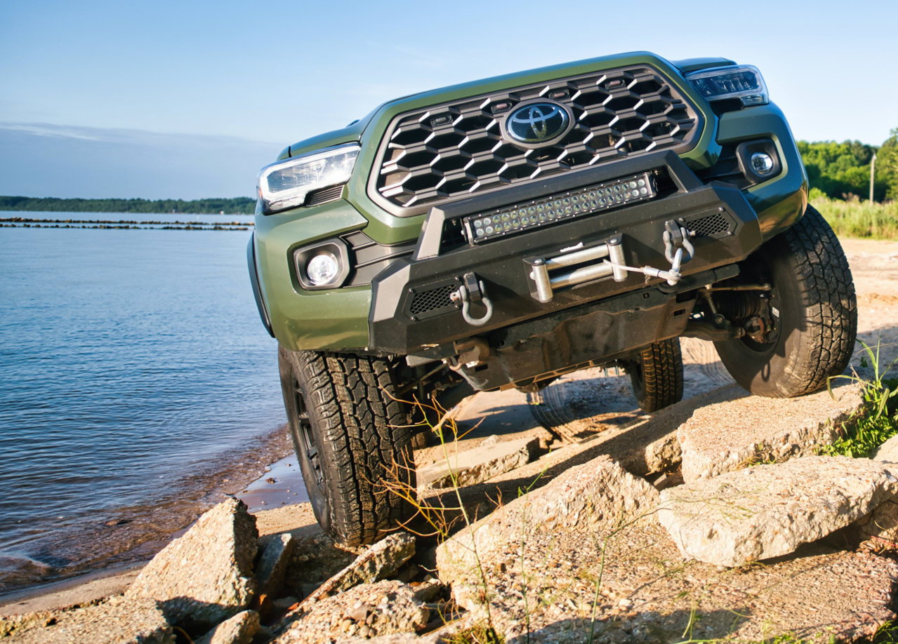

    mark
    2021 tacoma offroad
    2.5" pro comp lift WITH UCA"S, OFF ROAD BUMPERS, 1200 LB WINCH. OTT TUNE, BLACK CAMPER SHELL ROOF RACK.
