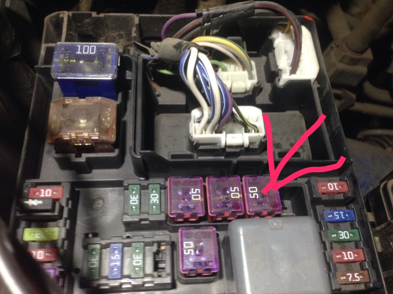

    So, I guess next, check the 50A J/B fuse in the under hood fusebox. If that is blown, it will also kill some other stuff too.

    yeah okay thanks! This is what I was looking for. I saw those relays in the back but didn’t know which relay was which. Thanks.
    Also do you know which 50a fuse to check? I wasn’t aware there was one connect to that circuit.

    Did you check the 50a J/B fuse? Is there voltage at that fuse?

    I believe the Power Windows are feed from that fuse.
    If the Power Windows work, the fuse should be good.
    As you stated, Is there power to the Fuse.

    So switch the relays with the power window one still works, checked the 50 fuse and it’s good and has power. Trying to make sense of the headlight switch but can’t really. What pins should I be probing ??
