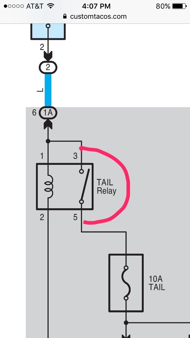

    tyoung has already determined that there's no power to the 10A tail fuse, so the problem has to be upstream from the fuse, which would be the relay, associated relay wiring and relay control circuitry. Before we get going in too many different directions, I think it's important to do the jumper I mentioned and then proceed in what ever direction those results send us.

    According to the schematic, it's terminals 3 and 5. From memory, I'm pretty sure those relay terminals are larger than the relay coil terminals. You want to jumper those 2 terminals together in the fuse box. That will send power from the 50A fuse to the 10A tail fuse if there's power available, and light the taillights. Make sure you don't jumper the relay coil terminals. If you do, it could let the magic smoke out of the ECU.

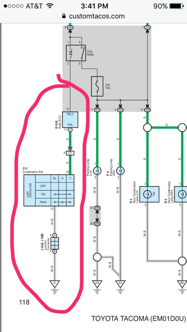

    OK, now we're getting somewhere. The problem has to be in the circled area. Either the headlight switch, or the body ECU, or the ground connection, or the wires connecting those points. The next step should be to find the green wire that goes to the headlight switch and ground it. Make 100% sure the green wire you find connects to the headlight switch. If you have the correct wire, you can't hurt anything. If the lights come on, you know the body ECU is good. If that's good, then ground the white/black wire and turn on the light switch and see what happens.

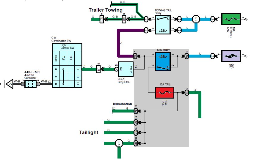

    A few other circuits that work off the TAIL relay to verify before probing and disassembly...
