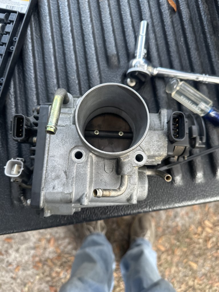

    I have a stock 03 Tacoma with the 3.4 prerunner. Replaced the engine with a JDM about 6 months ago. Been running great till last week. And I noticed once or twice that as I pressed the pedal there was no response from the engine but it would come back after a couple seconds and drive just fine. Just in case it is relevant I did nuke the original 250k engine when the lower hose let go(an hour away from replacing all the hoses had just got the parts) anyway I was watching the tps on my scan tool and it was normal then it happened, pressed the pedal and nothing just idled and no change from the tps. Tried raving straight at the TB and (cable not DBW) nothing for about 45 degrees then it started to move the throttle plate. I have opened it up and honestly it doesn’t look like it broke or twisted. Can this be fixed without replacing the whole throttle body. Oh and it’s the 4 wire tps.

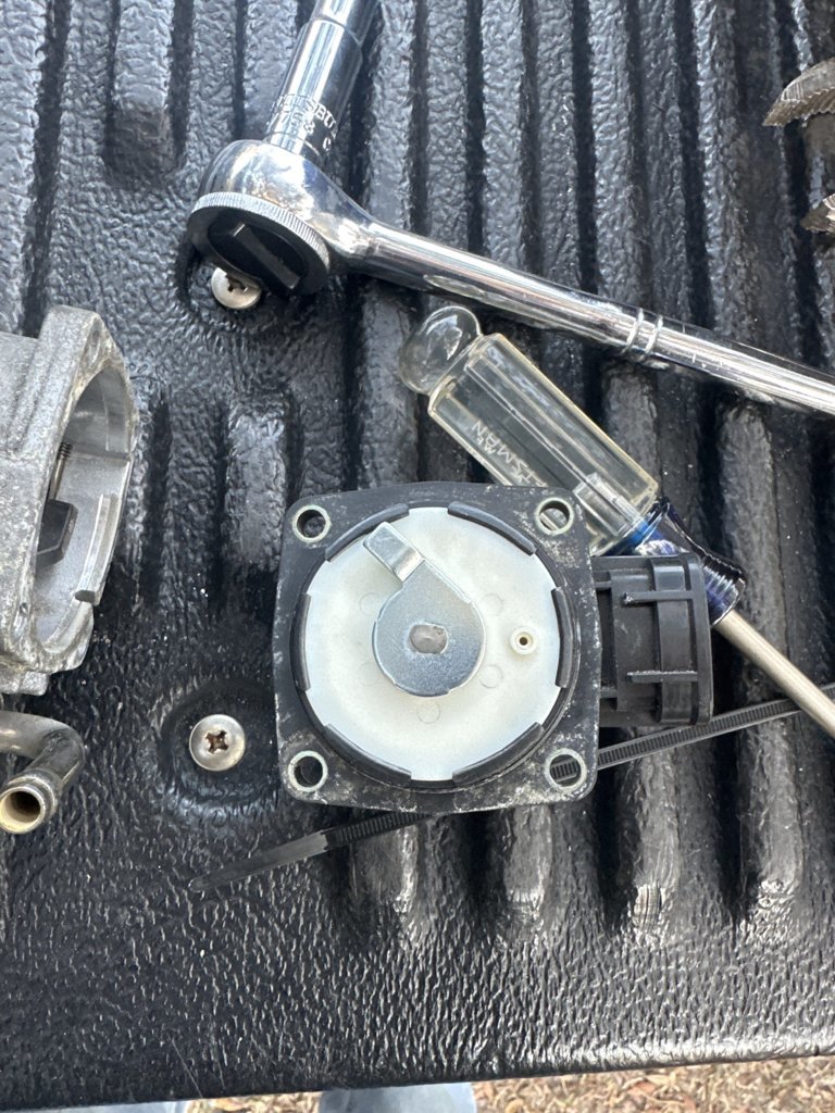

    Thanks for posting that pic inside the sensor......first we've ever seen that..

    So if I'm reading your post correctly, your TPS does nothing when the throttle is moved manually (at the throttle body)? If that's the case, I was precious under the impression that you cannot get the OEM 4-wire TPS sensor from Toyota. But then I found this:

    That's not the right sensor......thats on the other side of the TB
    03/04 are brandnew electronic TB's
    That cable sensor is integrated into TB on these.....and evidently toyota does want you to mess with it...

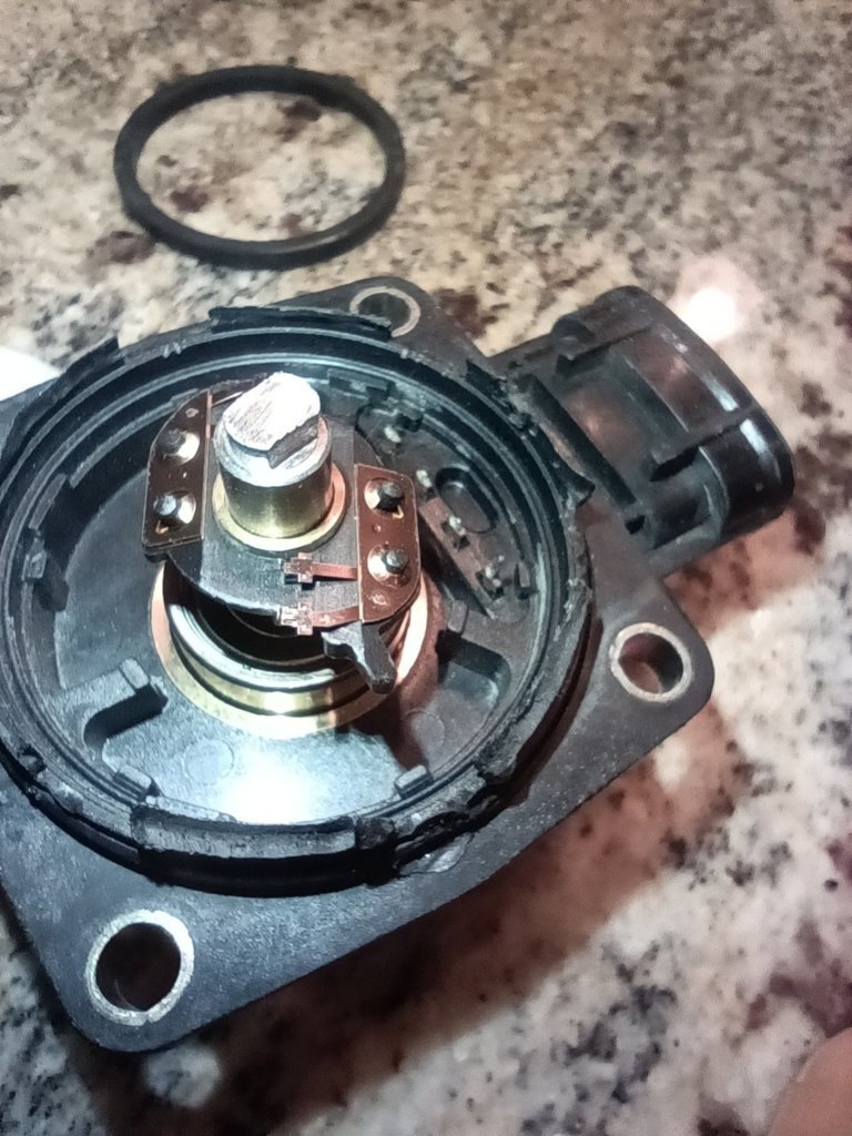

    To Red_03Taco can you take a pic like my 3rd pic to compare. I’d love to see a comparison to see if something shifted.

    Cleaning won’t fit it. The silver side is locked into its location and the black side(inside) is governed by the throttle plate. Which make it more confusing as to what changed without seeing a known good.

    The problem is gonna be under that plastic part in 2nd pic

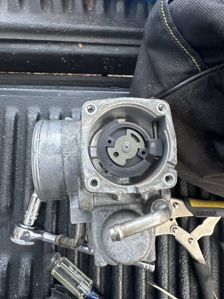

    And when you put that back together ....do you have to catch that little arm just right.....or hook under the spinning part in the TB
    slapped back together and may not catch right.....

    The silver arm seems like it should be in contact with the black nub on the TB. But unless I turn it 45 degrees it doesn’t. And everything feels solid like it’s as it should be

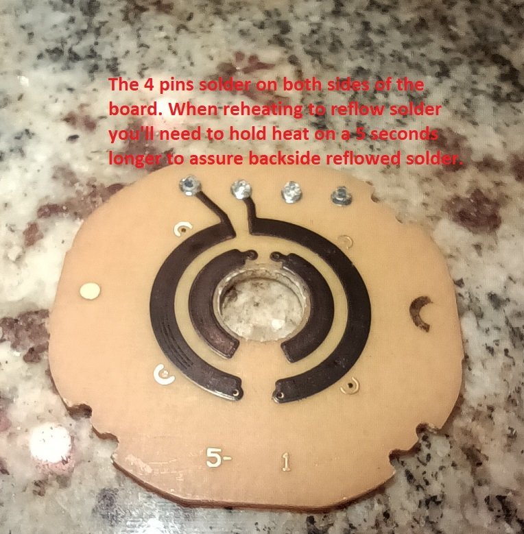

    Yeah on that last thread link I posted above....
    looks very difficult to get access to the contacts....beyond my skills
    and think its too tight just to shoot tuner cleaner....without taking apart
    very unusual that toyota doesnt sell a part....
    it must have to do with an EPA rule or mandate...
    Looks sealed pretty tight.......good to keep crap out......
    but dang hard to impossible to de ox those contacts

    You mean remove the sensor and take a pic of what lies underneath? I probably can't do that until next week because I'm moving tomorrow and all my stuff (tools, and the spare throttle body) is packed away and boxed up
