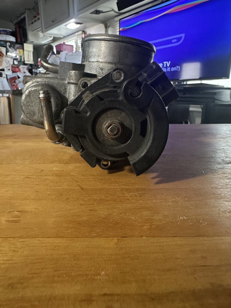

    thanks to your added pics.....we can now see its not a electromechanical failure....
    its feeding thru that shaft operating butterfly...

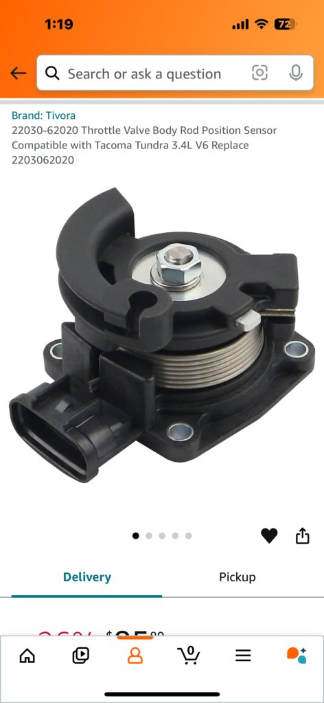

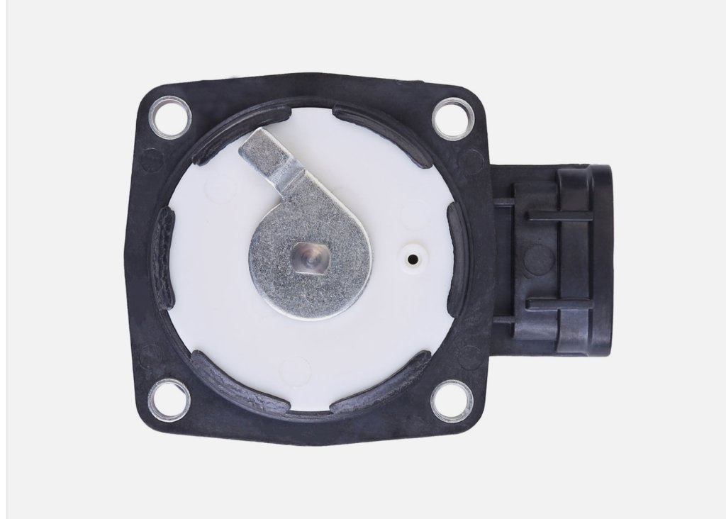

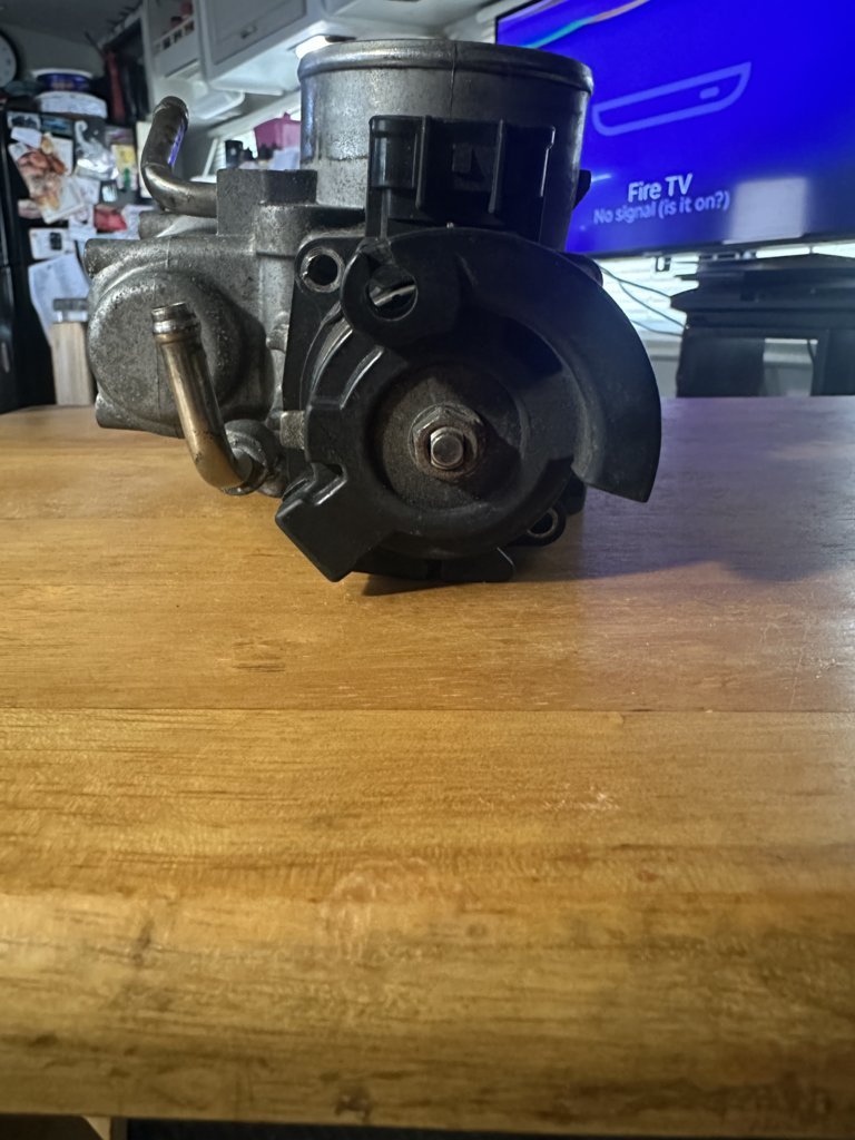

    Ok found a new part see pic, it is oriented the same as mine which leads me to think the issue is somehow in the TB.

    Ok crazy idea, maybe clock the part 45 degrees.

    First thought, the throttle body is functional again. The part number is 22030-62020 I got it from Amazon. Once I have driven the truck some I will update again.
    wish I could find the parts for the electric motor and gears for the TB cause I’d love to rebuild the whole damn thing.

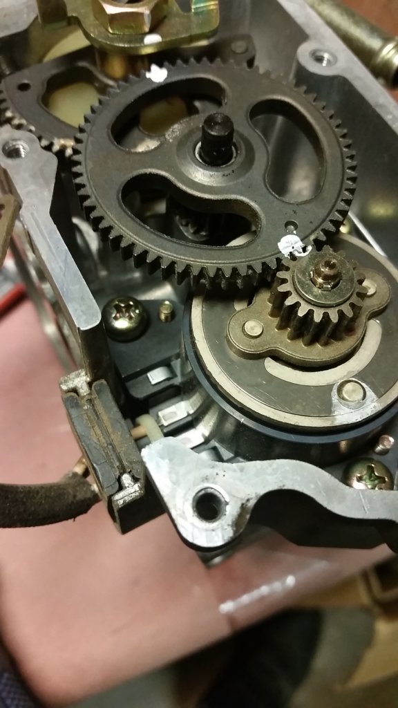

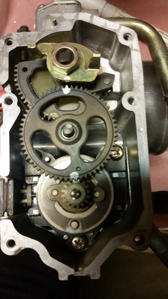

    There's no much to wear out inside. It's all pretty robust.
