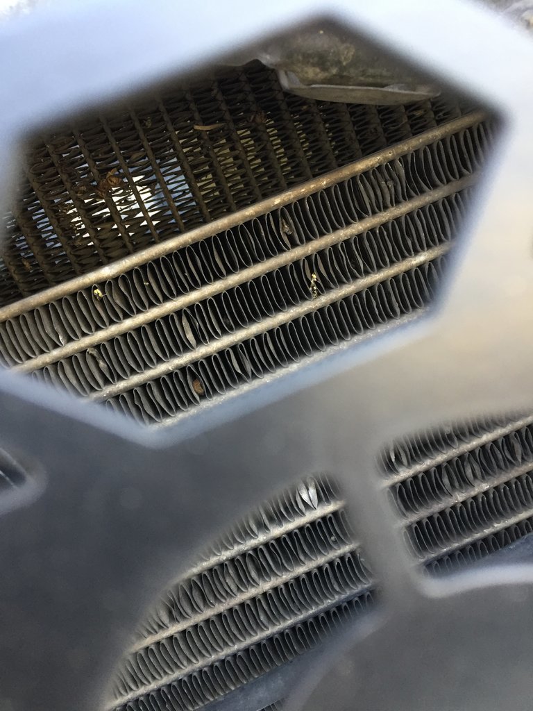

    What I believe what happened is at the production line, what ever was available they slapped it in. Being Orange hub is the most used they probably ran out and just used the green hub.
    oh, that's not the oil cooler its the A/C condenser. My oil cooler is sandwitched between A/C cooler and radiator.

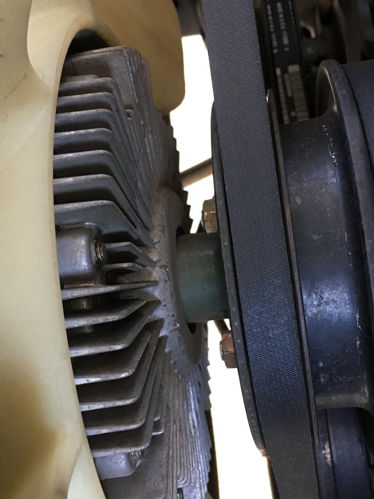

    Look under the hood can't miss it, attached to the fan.

    5100s w/ 881s, JBA UCAs, J59s, other stuff and things
    Greenish looking shaft. That it?
    Green denotes what again, exactly? HD package..?

    4,760
    the green fan clucth engages earlier and stays engaged longer for improved cooling at low speeds.
