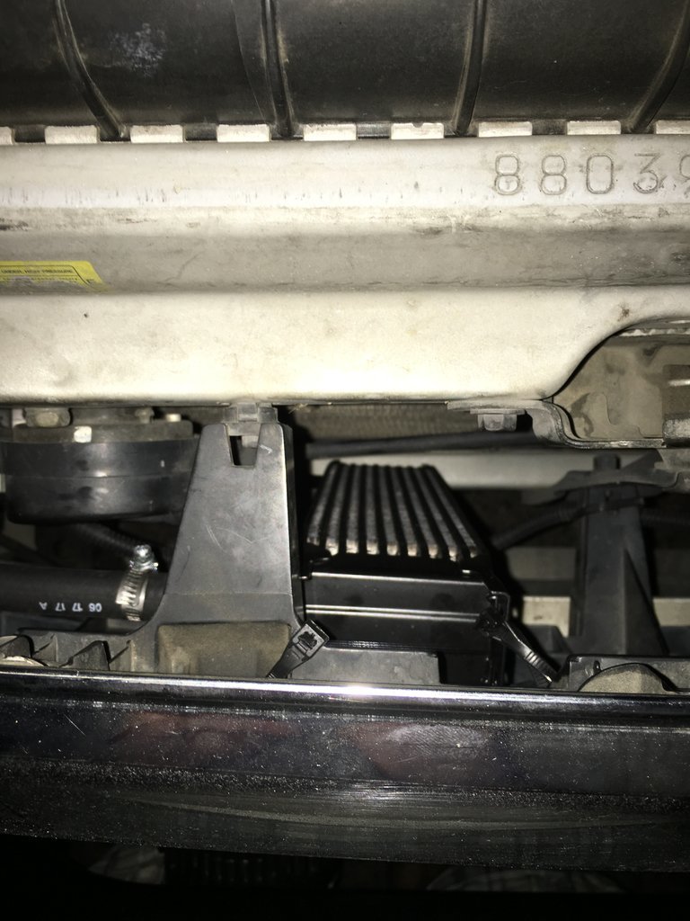

    Sorry for the delay in the update. The cooler and filter installation went very well. I changed all hoses while I had everything exposed just to be safe. So far I'm noticing a drop in trans temps by an average of 25 degrees or so. It cools down super quick at highway speeds. Very pleased with the products.

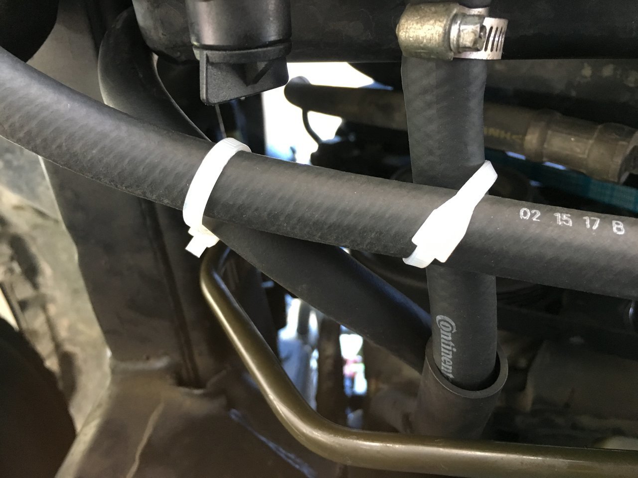

    The additional vinyl tubing is a form of abrasion protection to shield the cooler lines from rubbing against metal edges.

    looks good but I would rethink the zip ties on the cooler

    Why is that? If you're concerned about heat, the corners where I attached them do not seem to get hot at all.

    its your truck do as you wish I was just saying I would of went with a more secure option. what filter goes on the filter kit?

    No worries, I was just curious as to your reasoning. I zipped all four corners and there isn't any play so I feel like it's secure. I'll keep an eye on it. As to the filter, Derale has a part number for it but I can't remember what it is. I'm pretty sure it's good for 30,000 miles.

    awesome glad it worked out. I'm just usually ocd about stuff I install thats all. if I don't do it in a way that I know is completely secure then ill constantly worry about something happening. I just look at it like its a radiator. I wouldn't zip tie a radiator to my truck. obviously its much smaller but just the way my mind thinks thats all. wasn't knocking your method just my ocd kicked in lol

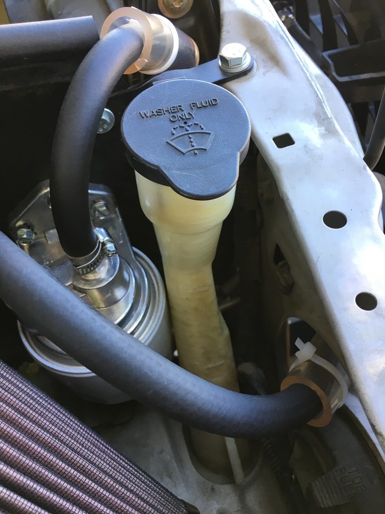

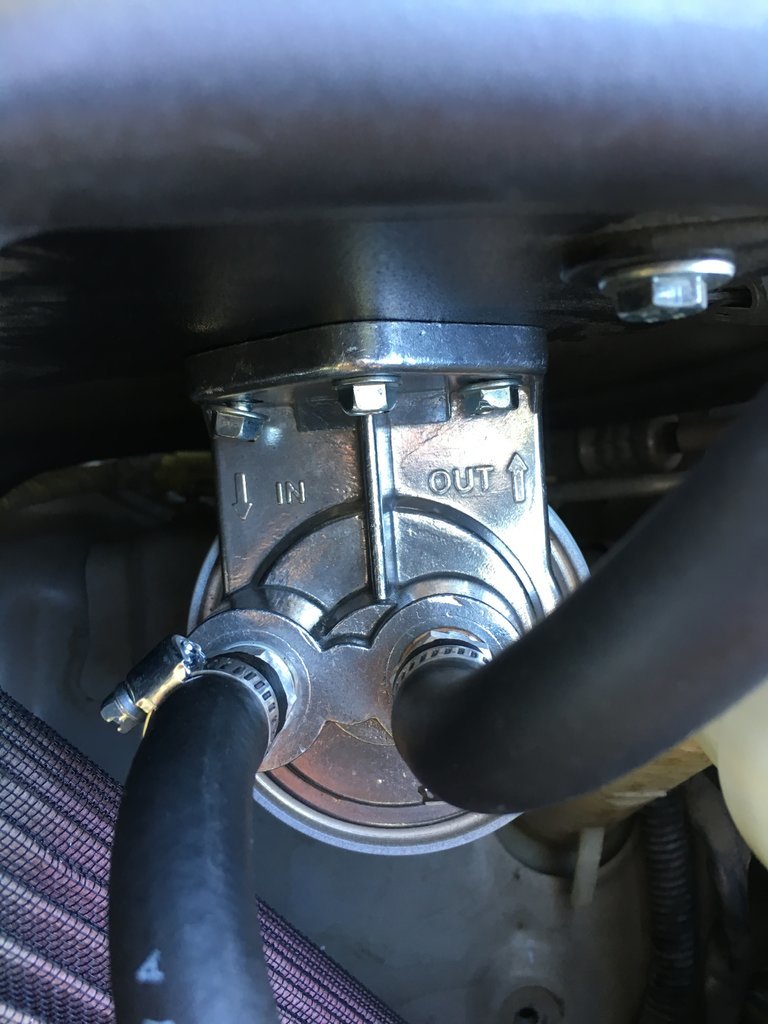

    that looks like a standard "filter relocation" part, minus the actual part that screws on where the filer goes. can probably find it on Amazon for pretty cheap. as far as filter there isn't much pressure on the system so you could go with any filter that fits the threads.
    I think @GEENYUSS is worried about climate. here in PA the temp can go from freezing to warm and can cause the ZIP ties to become brittle over time. if you live in a constant climate you may not have anything to worry about.

    I love in Sacramento CA, and the weather is pretty stable here. My truck has a "filter" inside the pan, but from what I've read it's just a screen that filters out large particles. Adding this in-line is an additional measure. Also slightly increases fluid capacity in addition to the cooler.
