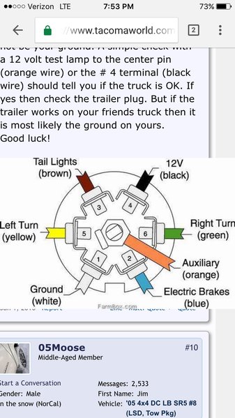

    I double checked my fuses under the hood and found that 30 amp fuse was blown. I missed it the first time I checked but that was my issue.
    Before you jump power from the lights to the plug, use a volt meter to see if you have power at your plug. Borrow one if you don't have one. Use this diagram to check power.
