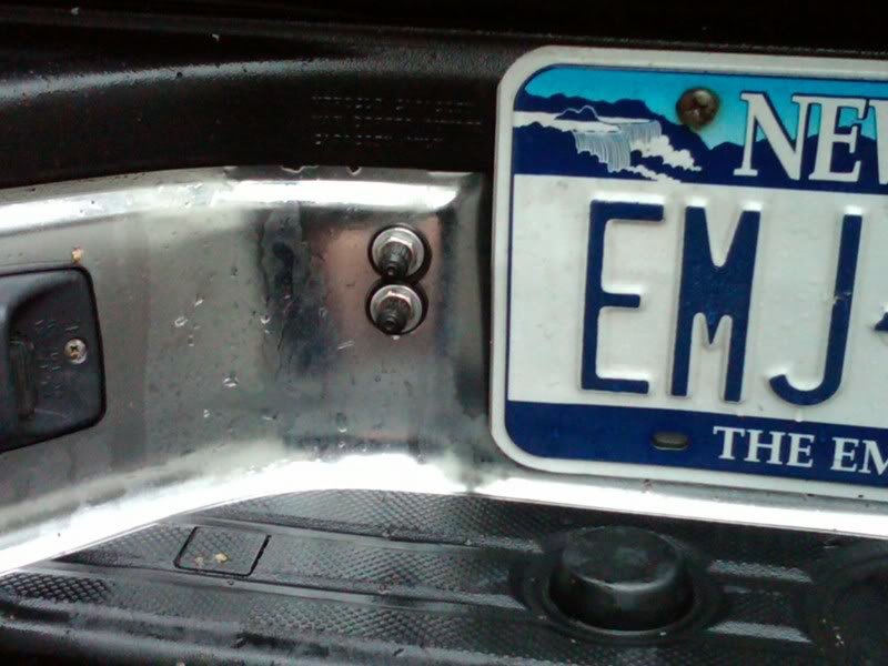

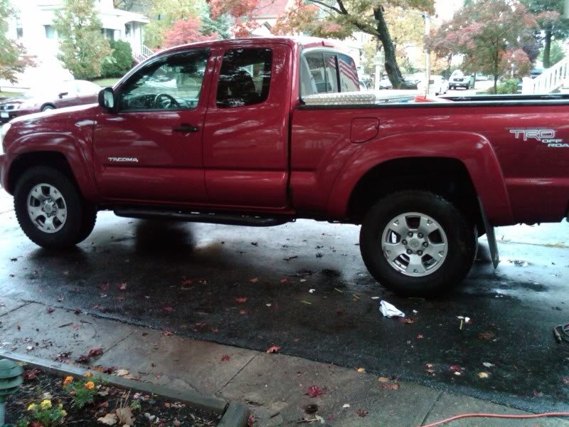

    So I was unable to get the TSB, no biggie, but hated the fact that it rode awful, and when i loaded it with weight (which I do often since i work with my taco) it would flatten the leafs out. I ordered a set of Air Lift Springs for the rear end. I ordered the Controler kit as well, but didn't install since it was pouring out, but I wanted to get the springs in and off my living room floor ( My wife was more concerned with them off the floor then me),
    Install time was about 40 Minutes, super simple, and strait foreward. And wow what a difference, I have them set at 30PSI, and the ride is so much smoother. I haven't loaded it yet, but can't wait to see how it does with some weight.
    At 100 PSI it adds about 4 1/2 inches of lift to the rear end, which is nice, because my front shocks are on their way out and I will up grade to the adjustable bilsteins to get a little free lift.
    Im not sure if I am even going to use the controller kit, I might just put an OBA system on and leave an air line back there....we will see...
    here are some pics...
    Anyone considering thie Air Lift kit, GET IT it rocks and its cheap.

    I've had the Firestone Ride Rite air bags for over two years now and wouldn't hesitate recommending air bags to anyone else with a Tacoma. I opted for the Firestones because they mount directly above the rear axle, versus the Air Lifts that mount and push on the leaf spring.
    As for the droop comment, the rear suspension is limited by the length of the rear OEM shocks. He can inflate, deflate the bags as much as he wants. The suspension will still only droop to the full extended length of the rear shocks - hence the rear brake line isn't a problem on a stock, bagged setup.
    As for leveling left to right - just inflate/deflate each individual bag. I usually run mine at 8 psi when empty and I have a fiberglass tonneau that must weight at least 100 lbs or so.
    I installed the air chucks in the predrilled holes in the bottom of the bumper. Didn't want to drill the chrome and introduce rust. I think there are 4-6 holes already in the underside of the bumper. I also bought one of those small, 12" long bicycle pumps that I keep in the rear seat pouch along with a digital air pressure gauge. Remarkably quick to air up after loading and be done with it. No need for the compressor system at all.

    Post pics. I wanna see what the hole locations you said in the post.. sorry if i post this but its true...

    Its almost winter here, salt and sand is a daily occourance on the roads - underside of truck is filthy so no pics.
    If you want to see the holes, walk to the rear of your truck, bend down, and look at the bottom edge of the bumper from underneath.
    Not being sarcastic - but come on now. How hard is it to look at the bottom of your bumper?
