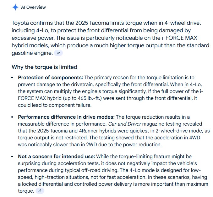

    I can't find anything official in any tech docs but if you punch it in to google you get this, makes sense they would want to limit torque to protect the driveline in 4L as your essentially multiplying available torque to the driveline by 2.5 in 4L.
    Easiest way to limit torque on a turbo engine is to open the wastegate and dump the boost.

    It's definitely wastegate on these trucks. Other trucks won't allow the throttle to fully open in 1st. There's lots people don't know about.
