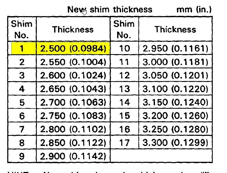

    ..That .002" is exactly the step size between each shim size...

    I mean, for all I know they have a 3.3mm shim in there; or equally they have a 2.5mm shim.
