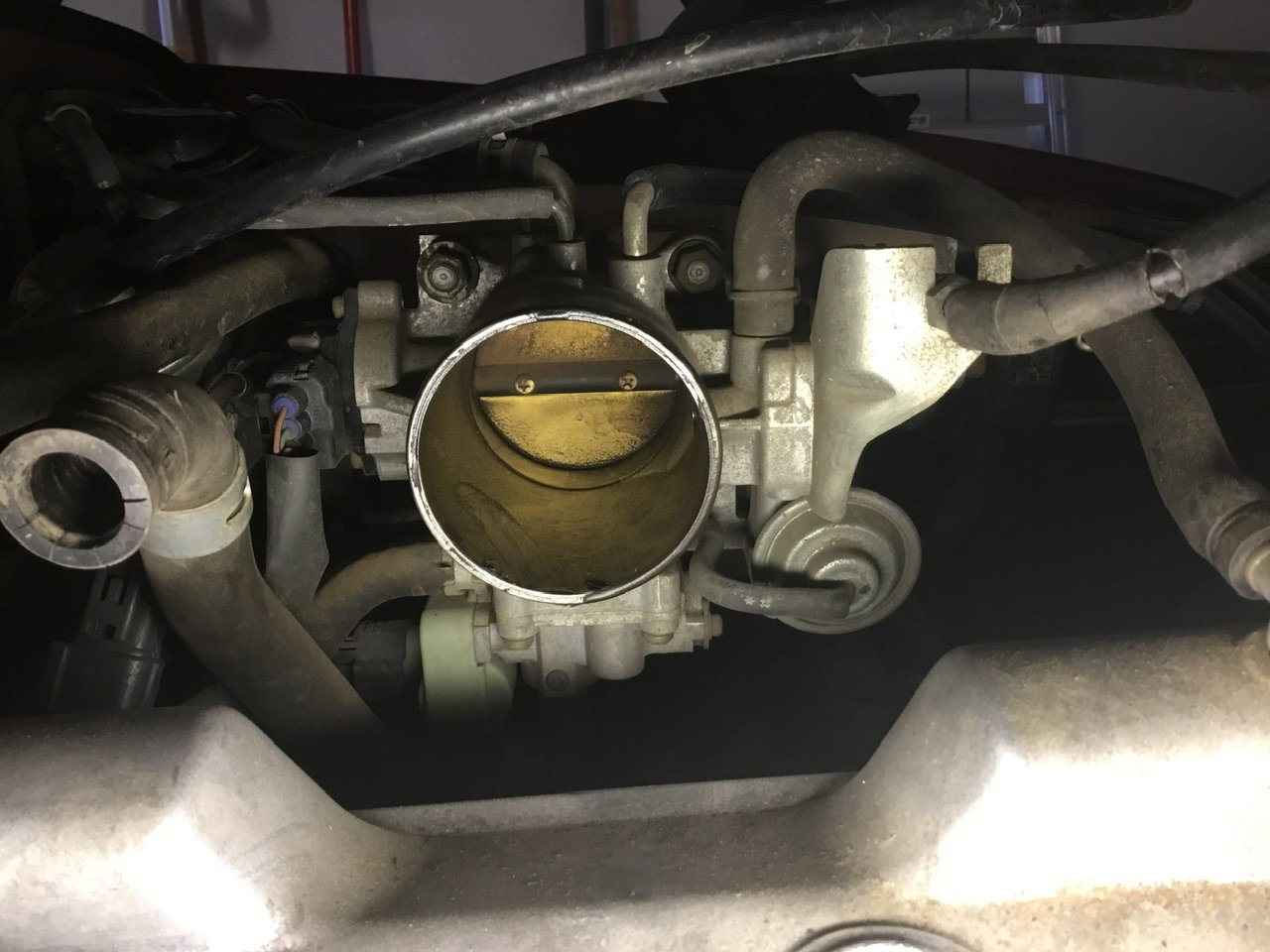

    The inside of my throttle body had some kinda of build up, possibly fuel and dirt? Normal after 240000. .

    I believe the PCV allows some small amounts of oil up into there too. Probably more oil and dirt than fuel

    I cleaned out the TB and the idle air control before reassembly.

    Ahhh- I just replaced the pcv and grommet. Hope that helps.
    I wiped it out but a thorough cleaning couldn’t hurt.
