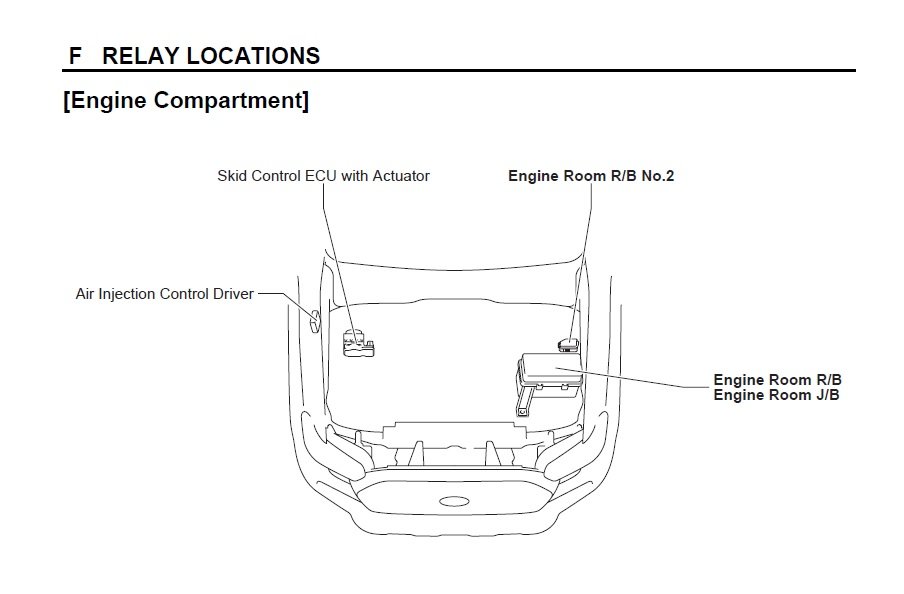

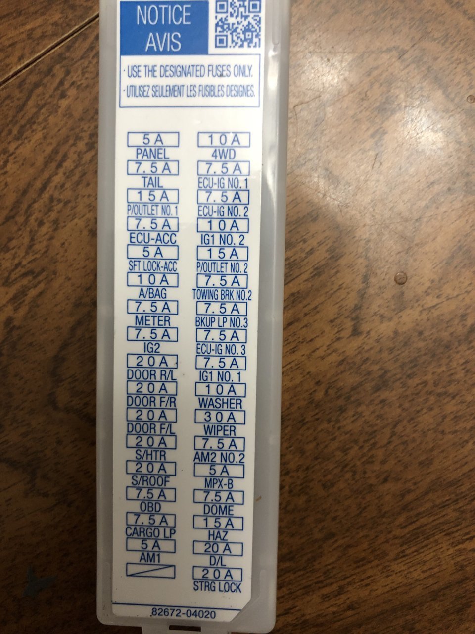

    Did you check both fuse boxes...under the dash and under the hood
    splitbolt likes this.
  5. Feb 19, 2019 at 4:26 PM
    splitbolt
    splitbolt Voodoo Witch Doctor
    Mar 7, 2010
    #32761
    7,858
    NW Arkansas
    2016 TRD OFFROAD DCSB MGM
    3 total...

    The 3 fuse boxes i see is 1 big one under hood and 1 small one with 3 relays to the right of the main one.... and then the one inside under driverside dash

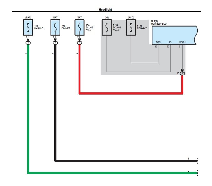

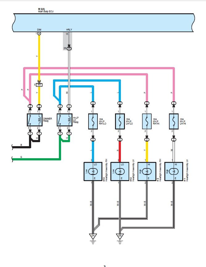

    If you are not getting voltage to the fuse, you need to check the relay. It powers the fuse circuit.

    I switched out (swapped) the relay from low beam to highbeam and the low beam still worked and high beam still did not. So i assumed the relay was okay (or not the issue).... is there another way to test relays?

    That should be a good test. I didn't see read far enough, lol. I would check to see if you have primary voltage to the relay. Pull it and check the pins. If you are troubleshooting this yourself, you will probably need an electrical schematic from AllData to find the grounds as well.

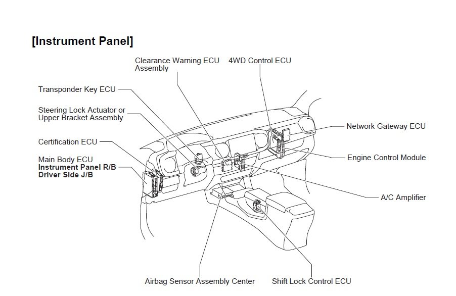

  16. Feb 19, 2019 at 5:42 PM
    #16
    maineah
    maineah Well-Known Member
    Mar 24, 2011
    #53641
    6,792
    Tim
    Maine
    4X4 SR5 V6 6spd
    If there is no power to the fuse no amount of grounds is going to fix it. The lights are on two fuses so if one is blown the other light will still work. So what supplies power to both fuses? High low switch? Is it relayed or part of a control module that operates from the key switch? Are they joined in the fuse panel and one connection to one of the fuses is fubared?
