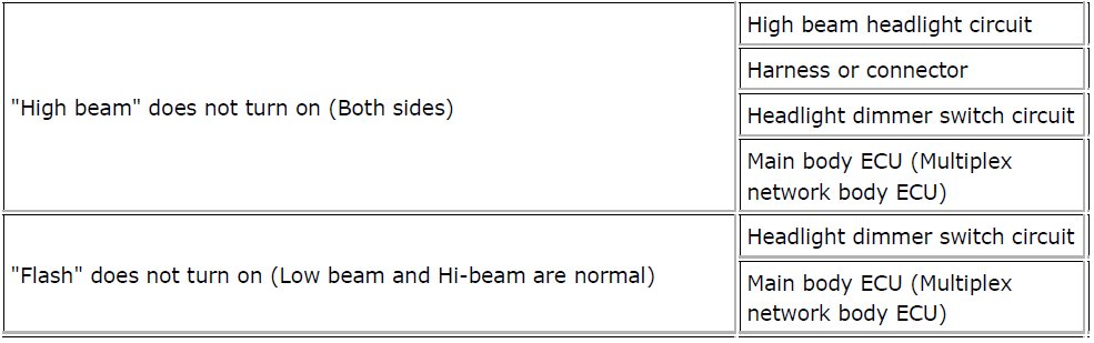

    Ok, do the low beams work as they should? Do they go off when you switch to high beams? What happens if you use the high beam flash? Do the headlights go off when you open the door key off? If the low beams work properly then I would look into the actuator for high/low it most likely drives a relay because the load is fairly high and the contacts aren't. Has the original owner added any weird things to the wiring? Generally wiring left alone does not fail switches and modules do.

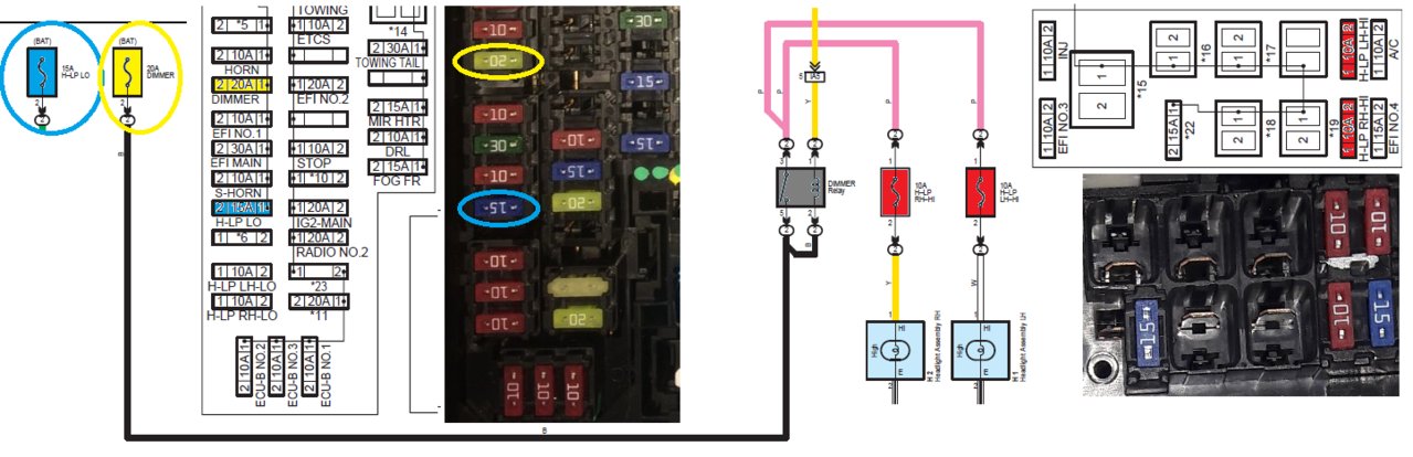

    with the voltage readings you got, that low would indicate a short i think.....if you had no voltage that would indicate an open or blown fuse or cut wire......right?

    If I’ve got this right. No power to the headlights (high beam) or the fuse the supplies power to them.
    You’ve check all the appropriate fuses.
    Checked the relays. (Swapped them and problem didn’t switch to Lo beam)
    You’ve checked the switch works (blue idiot light comes on)
    Next step should be checking the power to the relay. There are two powers, the two black wires running to the relay in the diagram a few posts above.
