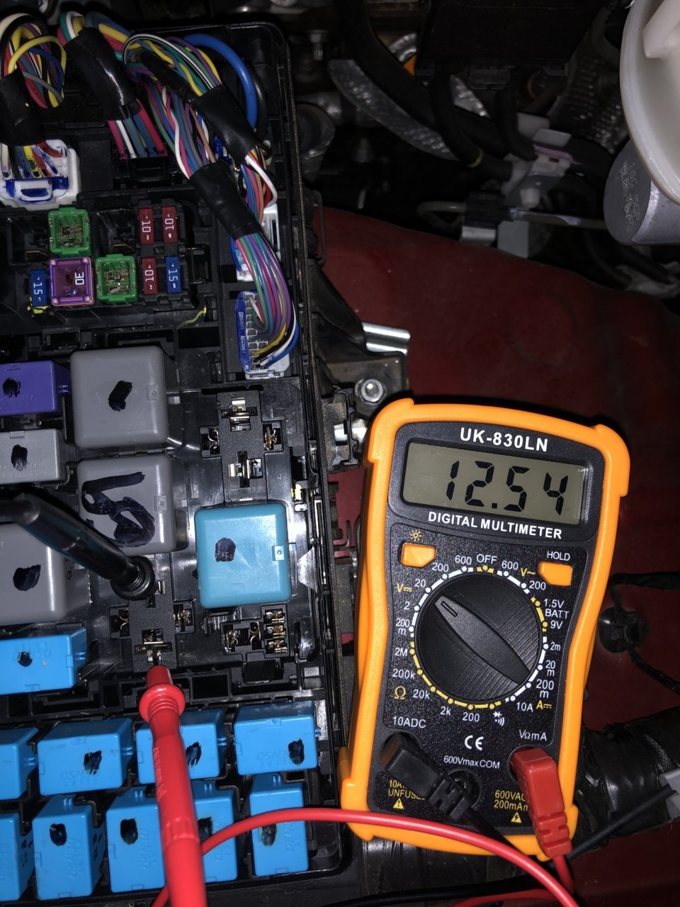

    Just looked at it with my multimeter and im getting 12v from the 2 big leads on the relay and 7v when i hook up one of the big ones with one of the small ones.... maybe someone who knows the schematic can help me figure out what these are supposed to be.

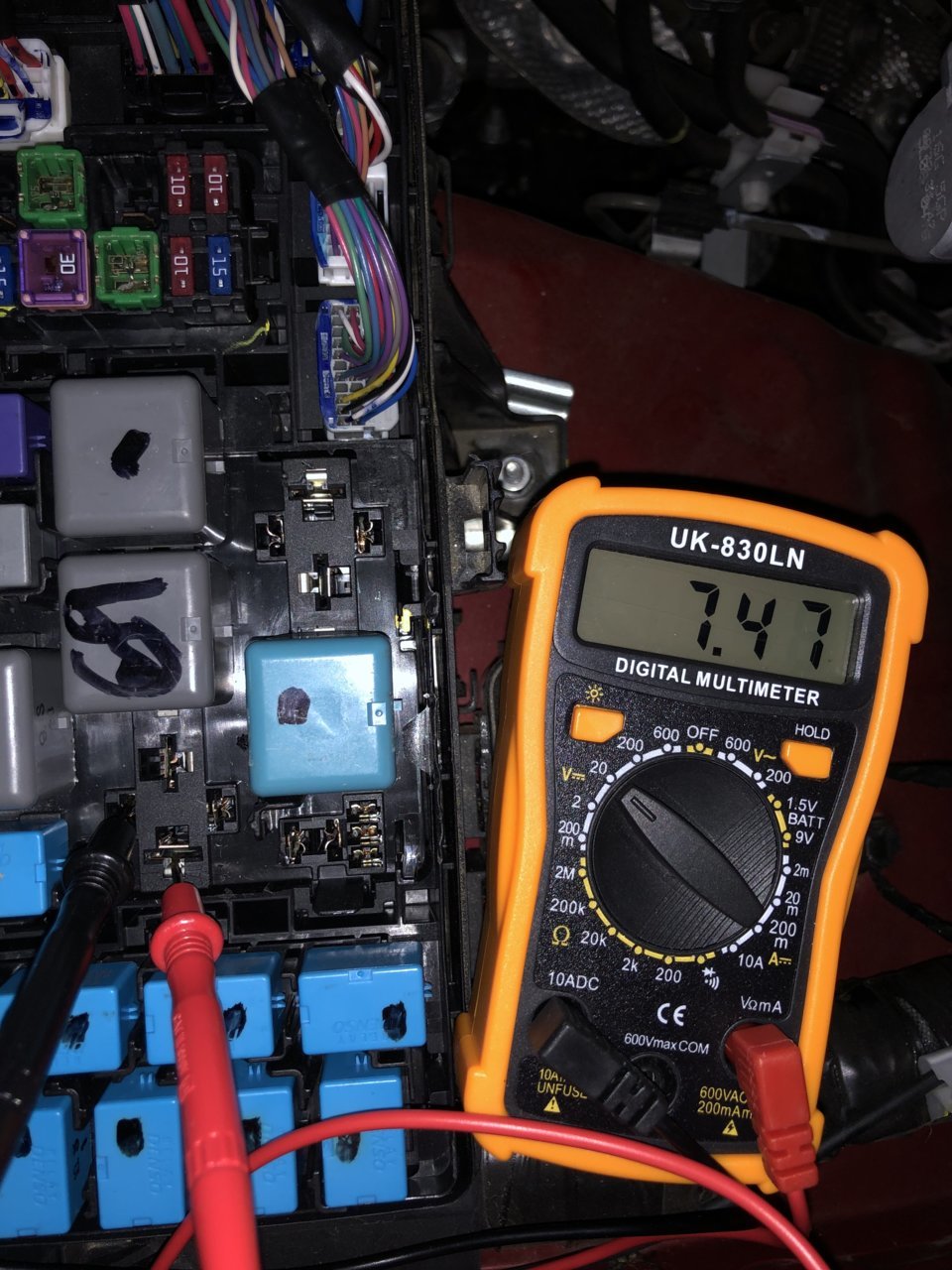

    Test with low beam on and high beam on and see if voltage changes.

    Yep when Highbeam switch is disabled i get 12v when I enable highbeams I get 7v

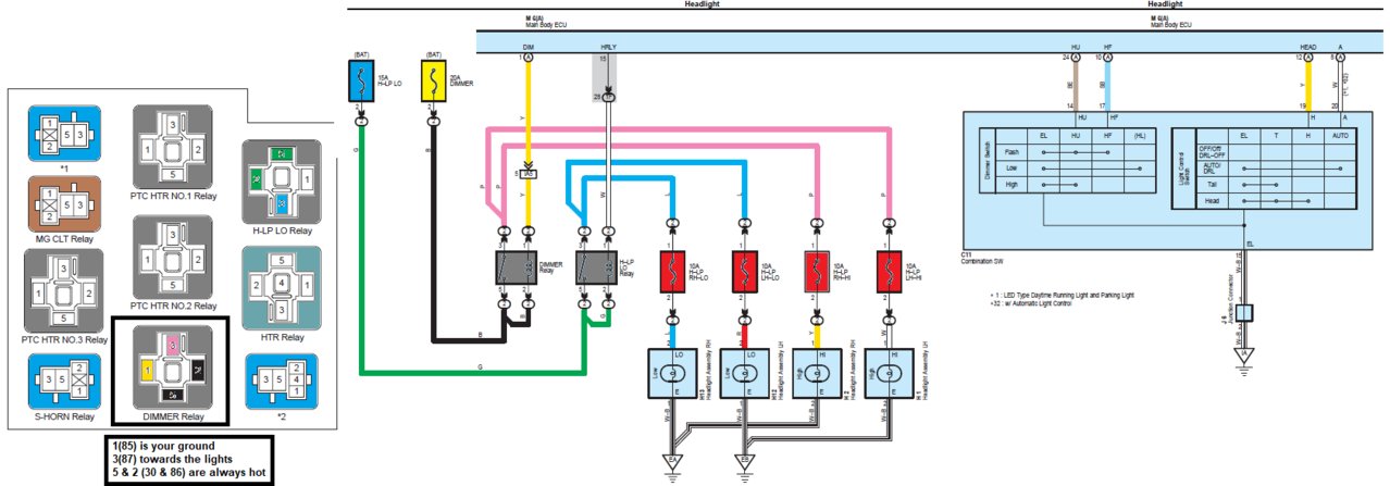

    So... relay is working, relay is getting power And The voltage adjustment is working... fuses are not blown, they are not getting any power tho... but if i take a short wire and connect one side to one of the high beam fuses and the other side to +12 the high beam lights come on ( no matter what position the switch or key is)
    Im so confused

    Ok... in order that u ask...
    Yes.
    No.
    High beams do not work, lows stay on, fogs go off.
    All Headlights turn off One minute after i open my door after i turn my truck off.

    Headlights relay is closed at the stalk (goes to ground to complete circuit)
