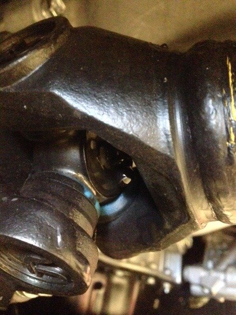

    Unlike the front driveshaft, the rear driveshaft zerks are located on one of the bearing caps and not the bearing cross.
    IIRC, greaseable u-joints have a blue seal and sealed u-joints have a black seal.
    Maybe even look for missing zerks...

    What he said... the rears are in a different location... first time I looked they were ALL pointed straight up and I did not see them..
