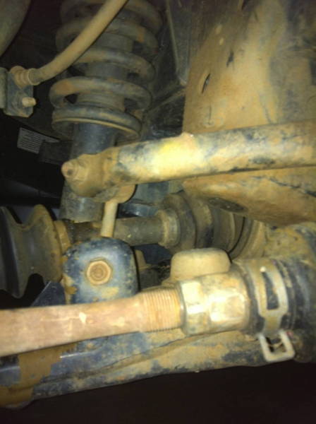

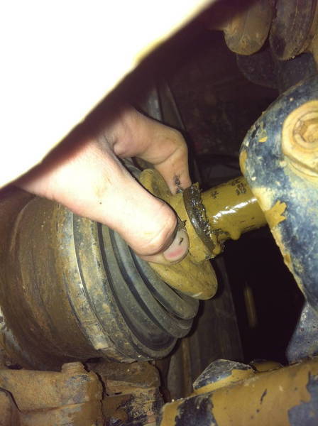

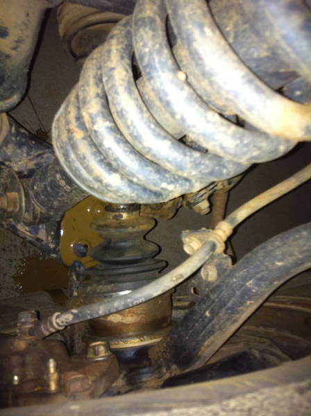

    I rotated the wheels like it was going down the road. Passenger side was easy to rotate. But driver side would turn 180 degrees then "seize" up until I forced it to rotate and then 180 degrees again it did the same. While doing all of this I was watching the cv. It would do a wobble motion or a unbalanced motion depending on how fast you turned it. I figured wen going at highway speeds or when ever it is turning it is cause the wobble feeling going down the road. Sorry if I repeat myself, I'm doing this on my iPhone. I will take pictures when I get off. They won't be good cause I will be going to school shortly after I get off.
  16. Feb 14, 2012 at 7:26 PM
    #16
    GATORTACO92
    GATORTACO92 [OP] Well-Known Member
    Jan 15, 2012
    #70702
    2,251
    Alex
    B'ham, AL. Can be found in good ole Cherry Point,
    2015 Tacoma Trd sport 4x4
    2001: 3" leveling kit, ARB bumper, lightforce 240 blitz, 35" KM2s. SOLD 2008: OME 886s 90000 with dakars, LR UCAs, 5% tint, Satashi. SOLD 2015: stock....for now
    pics. i have a video of the noise. it was taken at dark about 10 min again.
    it looks like a normal driveshaft until you actually see it in motion. with the wheel off and on stands.
