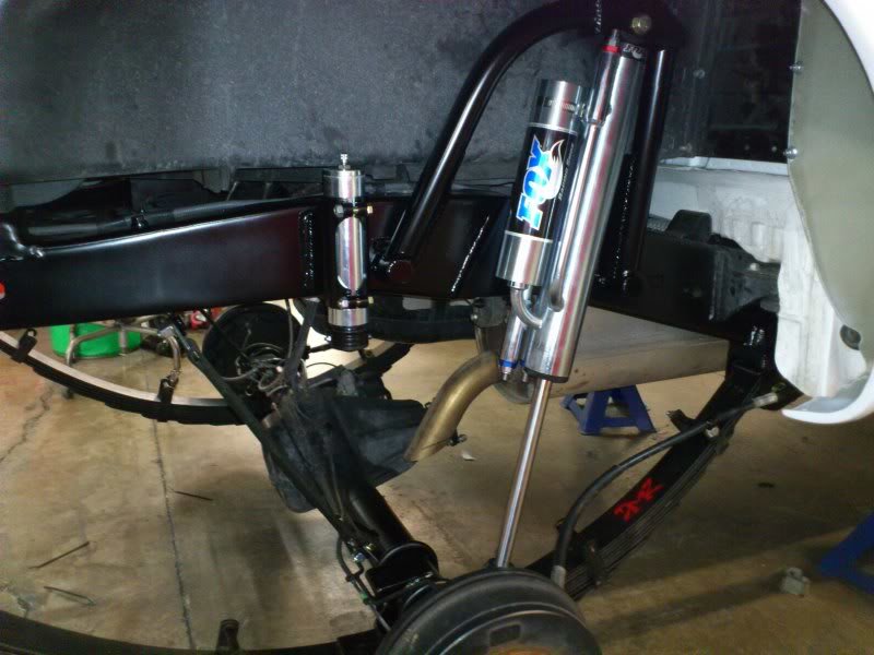

    I dont think you will need to notch the wheel wells, just lean the shock forward a little more and tuck it into the front corner of the wheel well. Also you can integrate the mount into the tube work like Fixedtrd did on his truck.

    that is sexy.

    Yeah his truck is pretty sweet!
