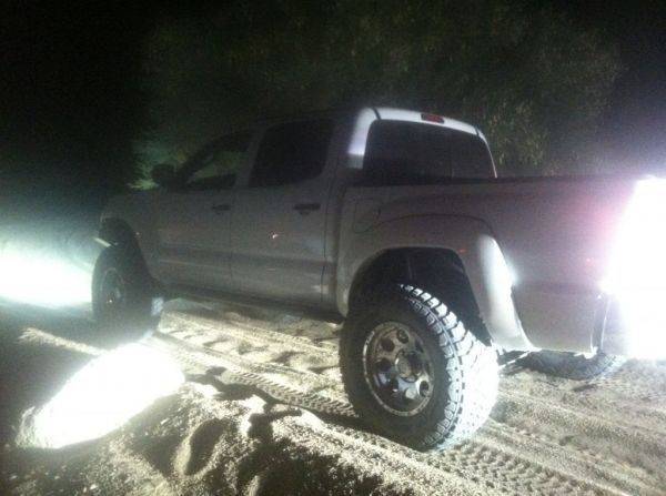

  12. Jul 13, 2013 at 10:29 PM
    #3672
    PLC721
    PLC721 [OP] Well-Known Member
    Dec 27, 2009
    #28268
    18,957
    Patrick
    Chandler, Az
    2017 Toyota Tundra Crewmax ProKiller
    Kings, Toyos, Baja Designs, TC, SDHQ
    Night run tonight :woot:
