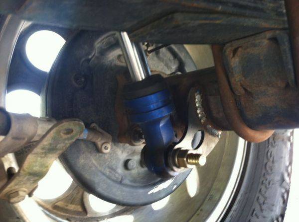

    Oh well that's good cause I already have spacers in the rear so I shouldn't have any clearancing issues:cool:
    Any shots of the mounts on the axle?

    here ya go Max

    Thanks,
    Nice and clean mounts :thumbsup:

    im a little worried with them being on the front of the axle, but i really don't think ill have any problems

    I don't think it'll be an issue since they're so close to the outer wheel. Might have some increased axle wrap but only slightly if at all :cool:

    I got the lower mounts from Sdhq, the most time consuming part was cutting off all of the old stuff
