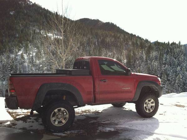

    Yeah,
    I read a lot about this before I decided to go with an OME 3" complete lift on my 09' Taco reg cab 4x4. I went with a complete leaf spring kit, 885 coils w/ 3/4" front spacers. I am still running 16" wheels w/ goodyear wrangler duratrac tires. I was really hoping that after having this kit installed professionally, that I would not be a victim of "the noise" that seems to plague 4 banger tacos w/ a lift kit.
    So, "the noise." I am not a mechanic, but I am somewhat mechanically inclined. That being said, I've read about a lot of different remedies for this noise, which consists of a vibrating that happens in the driveshaft or diff. when you take your foot off of the gas and you're going faster than about 55. I don't think it happens when I'm in 4wd, so it must be the rear shaft. But then again I never go faster than 50 or so when im in 4, so it's tough to say, but I don't think it happens in 4.
    I've read about some remedies which include; Simply flipping the rear driveshaft from end to end (some say it works some claim nonsense), installing the 3 degree axle spacers that OME offers, getting a new 2-piece driveshaft to compensate for the now "whacked out" angles that lifting the truck caused where the shaft meets the diff? I think? At any rate, as I am not a mechanic and only somewhat mechanically inclined, I was really hoping someone on here with a 2nd gen. 4 banger, lifted, would have some answers to this problem, for a grateful tacoworld member:) I know there are others' who have run into this issue, so hopefully some folks can chime in w/ a little insight!
    I hope everyone that reads this has a phenomenal day and an even better night! God Bless you and your family and friends.
    Clint

    First, the front:
    Whoa - 885 springs AND a 3/4" spacer? Do you have any downtravel left at all? Actually, that photo doesn't look like the front is crazy high - are you sure you didn't perhaps use 884 springs with a spacer? Measure from the center of the front hub to the bottom of the front fender and report back.
    Now, the noise.
    Yeah, a loudish noise through the cab when you let off the gas going around 60 or 55, is probably the rear driveshaft. You can't "change" to a 1 piece driveshaft, because that's what you've already got. The "carrier bearing" driveshaft is only on the longer access and double cab models.
    It's pretty easy to end-for-end swap the driveshaft. Try it out if you want too.
    Aside from that, maybe just grease your driveshaft zerks and then don't worry about it.

    Holy crap , how much lift did you get with that set up on a reg cab ?
