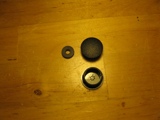

    FYI, I used plugs from Ace Hardware. They snap right in. Find them in the bulk bins. P/N 58138-D. When I removed and re-installed the air dam bolts I used 1/4" rubber flat washers to help keep the bolts from loosening.
