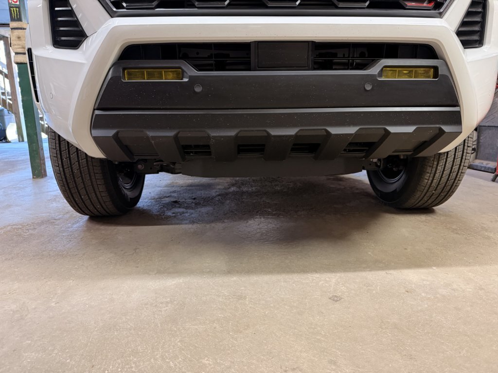

    I trimmed mine down to cover the skid plate gap and NO funky whistling like people are getting. IMG_4309.jpg
    Steves104x4 and thefinalstraw like this.

    that looks great! how many bolts did that leave?

    I don’t remember exactly, 4 ?

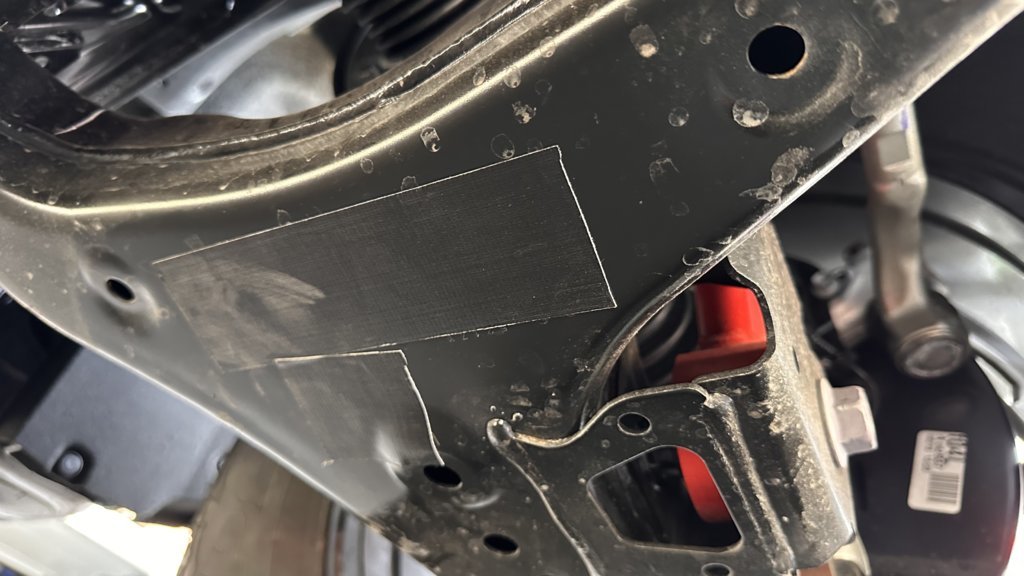

    I removed the air dam and sure enough I didn’t have the plugs. I got the noise but it’s not a whistle but more of a whirling sound. Very noticeable so I patched it up with gorilla duct tape for now and ordered the plugs from Amazon.

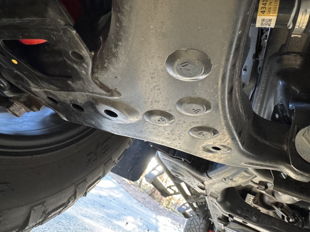

    folks - don't plug the two holes that aren't flush with the surface. they don't contribute to the howl, and you need to leave a couple open for drainage.

    I did 4 per side, following someone's picture of the factory plugs on a truck that doesn't have the air dam. Am hoping that if Toyota plugged them, then it's OK. Too hot to crawl under there now to look for any that aren't flush, but I think I'm OK.
