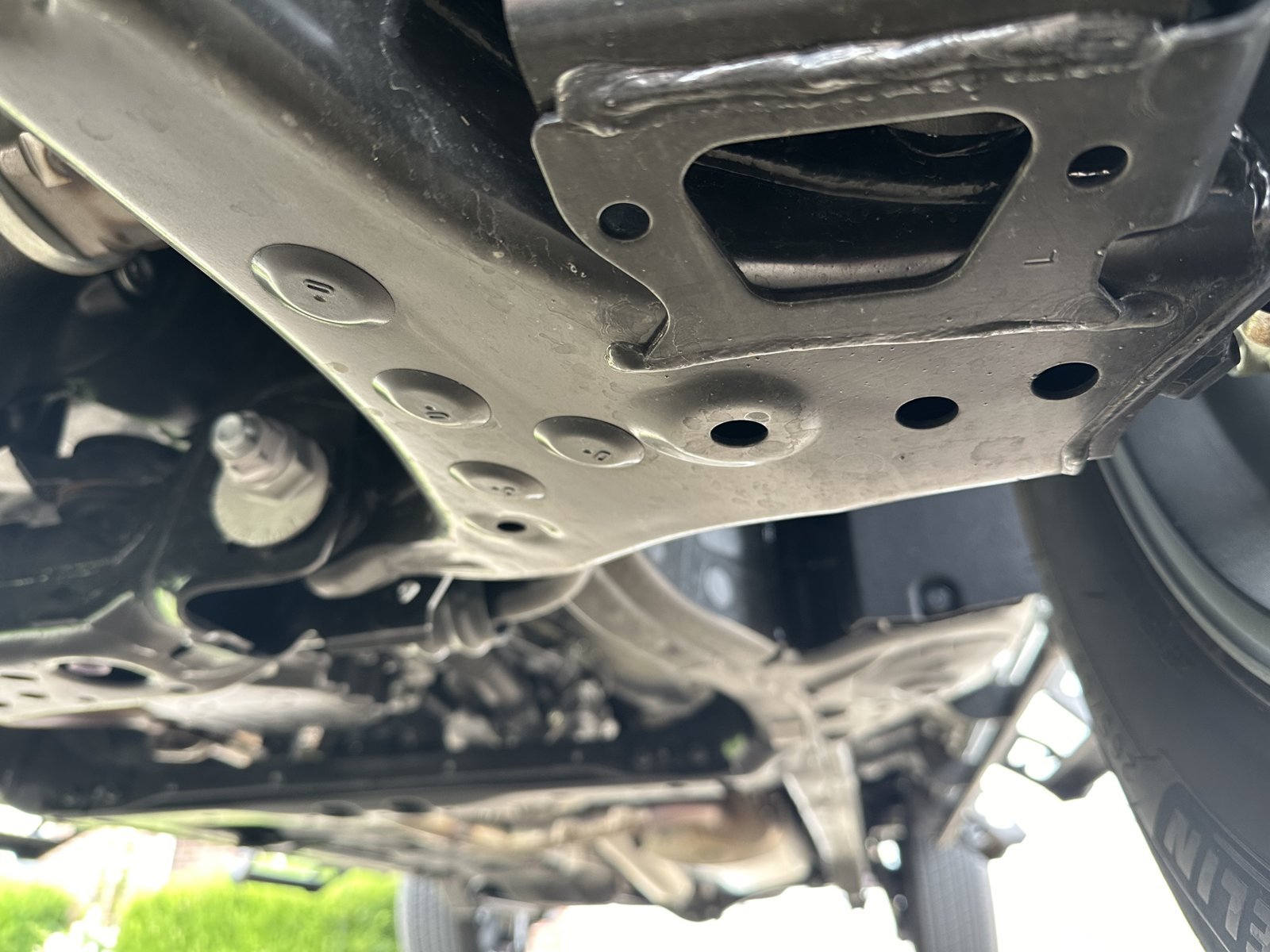

    you are 100% correct. I had posted earlier in the thread that I did not have the howl on my Sport, however, I must have missed the pictures posted earlier. Just went outside and lo and behold mine came installed with them in these places which now makes sense that I wouldn’t have the howl:

    The plot thickens... Pisses me off I paid $60 CAD for plugs that perhaps "should" have been installed in the first place! I'm already imagining the battle with my dealership.
    So at least now we know that those of us who have the howl are not crazy! :rofl:I wondered how those who said they did not have the howl could miss that as it's a really loud annoying howl you could hear over the stereo, A/C on full and cooling seats on full as well! Turns out they have the plugs already installed! Now how do we convince Toyota to reimburse those of us who bought these plugs?

    I went under my truck today and saw that I do not have the hole plugs. I measured the holes at 0.75 inches so I am going to go to lowes later today and buy some plugs which are $0.89 each. Hopefully that works and I will report back

    I went to Lowes today and bought these: https://www.lowes.com/pd/Hillman-2-Pack-0-75-in-Black-Plastic-Hole-Plug/3109075
    It fixed the problem (YAY!!) but they are too loose in the holes for my liking. I could easily pull them out with my fingers. But they didn't fall out on a drive on the highway.
    So I am just going to get the Toyota ones for a better fit and stomach the $25 for plastic plugs...at least they are on sale right now.
