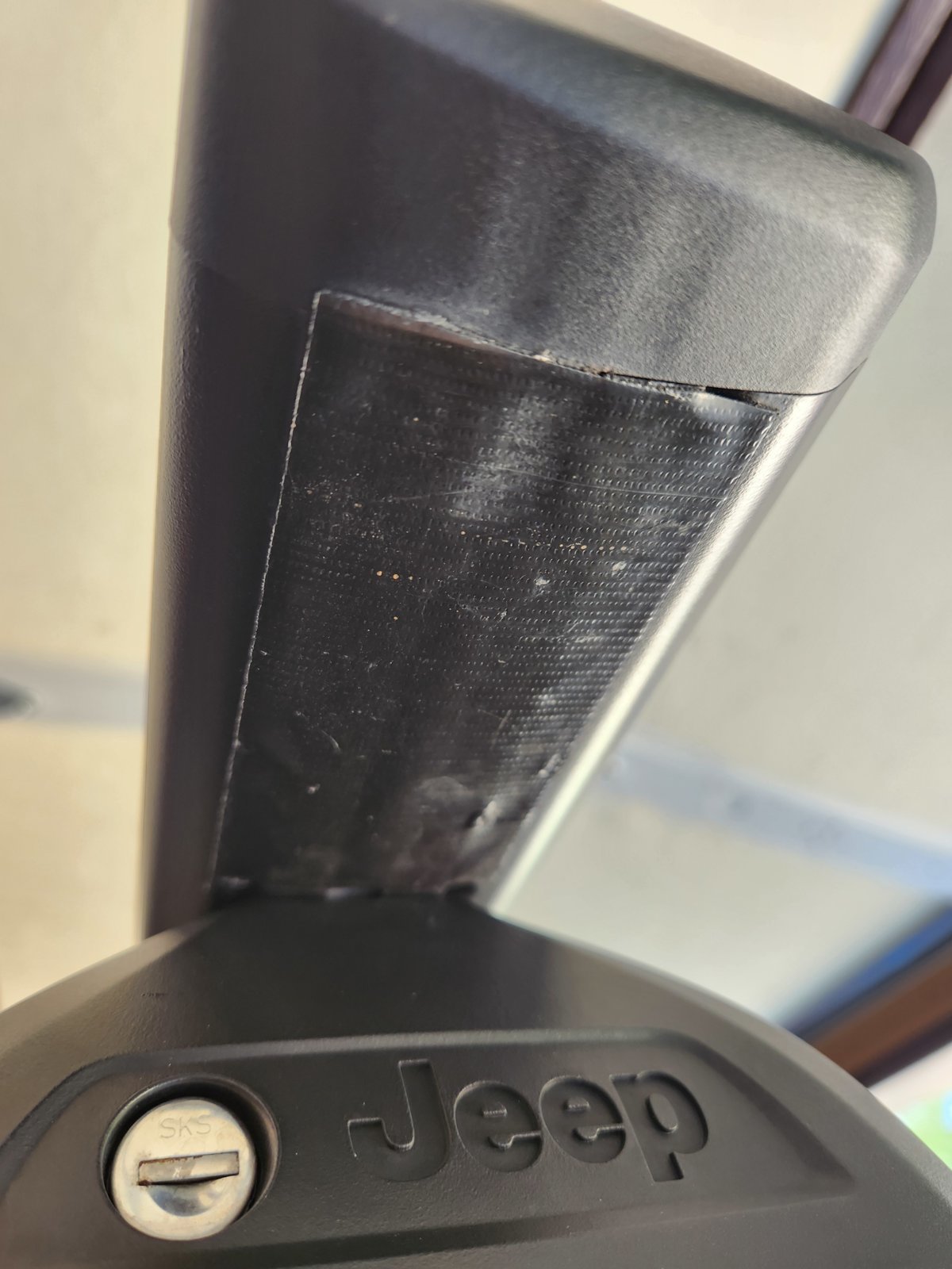

    2024 Bronze Oxide TRD OR
    Clean the surface and use this tape. It has been on my jeep roof rails for 6 years and looks brand new still.

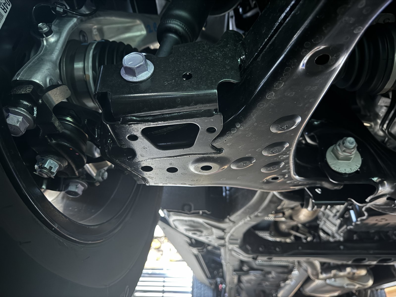

    Just checked and they are installed on my SR5. Good to know, getting ready to remove the air dam!

    Is there no crossmember due to the longer bed/box or just something they omitted from the Sport model?
    I have a deposit on a Sport and considering holding off another year and see how things progress.
    Took one for another test drive yesterday (3rd time out). I liked the truck but not sure about the value and reliability on the new platform, obviously too soon to say.

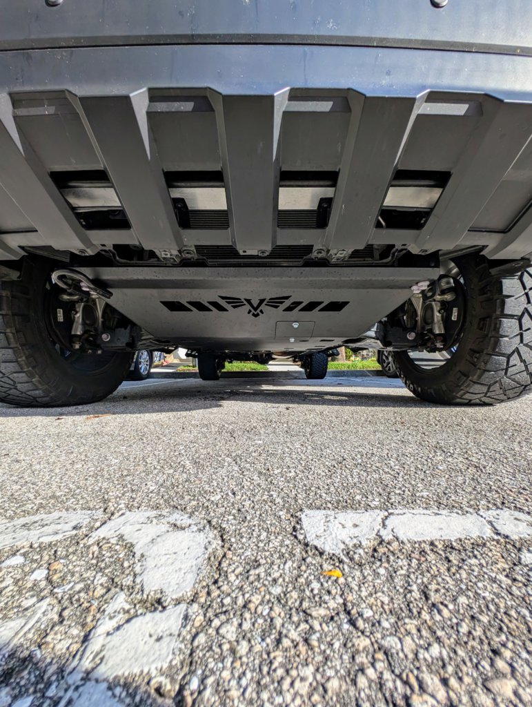

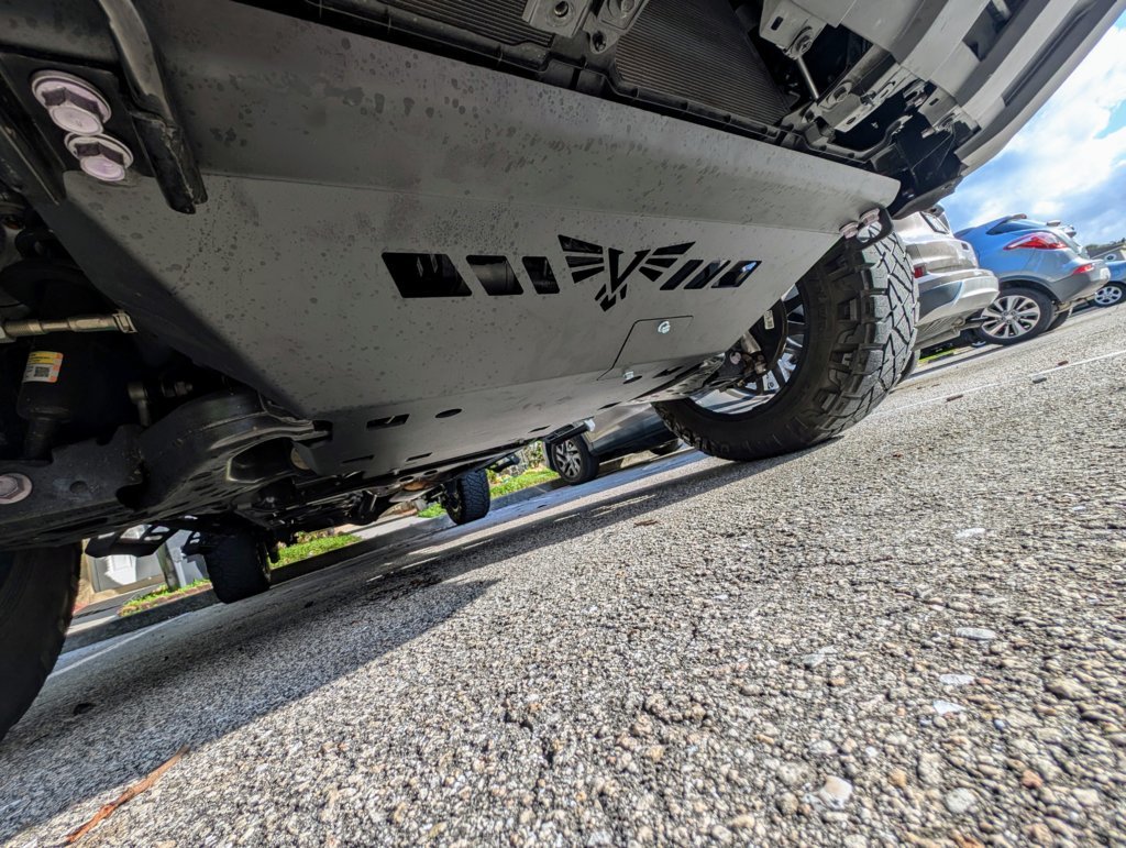

    20 inch Fuel Rebels on 33s Front Skid Plate
    If anyone is looking at getting skid plates I just installed the Victory 4x4 one and it did the trick as well for eliminating that noise

    Nice, and I see it's specifically designed to fit Tacomas that do not have the crossbar. How good is the oil filter and oil drain plug access?

    Evan
    2024 Tacoma Sport - Underground
    It's got a little mini door access there held in by a couple of bolts, super easy access.
