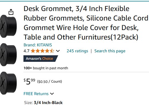

    I got these from Amazon for $6...
    They worked perfectly. And yes, remove the air dam, and put the screws back. Not for noise reasons, just to put them back where they belong...
