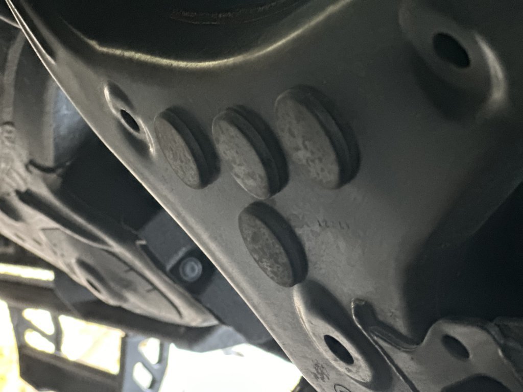

    What trim levels are they? Looks like some trucks came with plugs already installed (OR, some SR5 's). Just have a peek under your LCA' s you should be able to spot them (or not).

    Well im pretty certain i didnt hear the noise on my original sr5.
    Never crawled under the early build sr5 to verify if it had plugs or not.
    can totally hear the noise now on the sport.
    something like 35-45mph, whining wind noise.
    just crawled under her & zero plugs, its a sport that was just built very recently....
    Going to call my writer at the dealer tomorrow & see if theres a warranty work-around to get some free plugs.

    So heres an update...
    Texted my local toyota service writer last week with a picture of the lower control arms with the plugs along with the picture of the bag of plugs / part #......
    Brief explanation explaining some of the trucks come with the plugs while others dont.
    He mentioned he cant give me a for certain coverage response but to bring in the truck when I can so we can start the hoop jumping & see if we can get it covered.
    Well today & drove it in, they checked it out while I waited, verified the noise, etc...
    I have no idea if theres some sort of technical bulletin or not.
    Bottom line, with zero reservation / push-back, they ordered $60 with of plugs as theyre SOP....
    Sent me on my way, & will call me when parts come-in...
